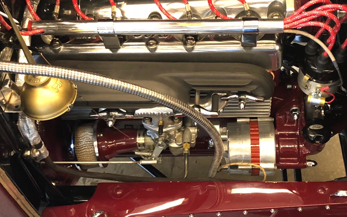

I gave no thought to a fire hazard, but with the filter higher and the other side of that window screen it should be OK. A guy could also put a second screen layer in there for more of a flame arrestor. Good suggestion to drill a wee hole at the lowest point (where the hot-air tube enters the carb). A timely discussion to be sure — I've not carried a fire extinguisher in this car and need to mount one before the tour.
Re: Funky Air Cleaner
Posted: Mon Jun 14, 2021 8:42 pm
by Henry K. Lee
Another option.., facing towards the back.
Just trying to assist,
Hank
