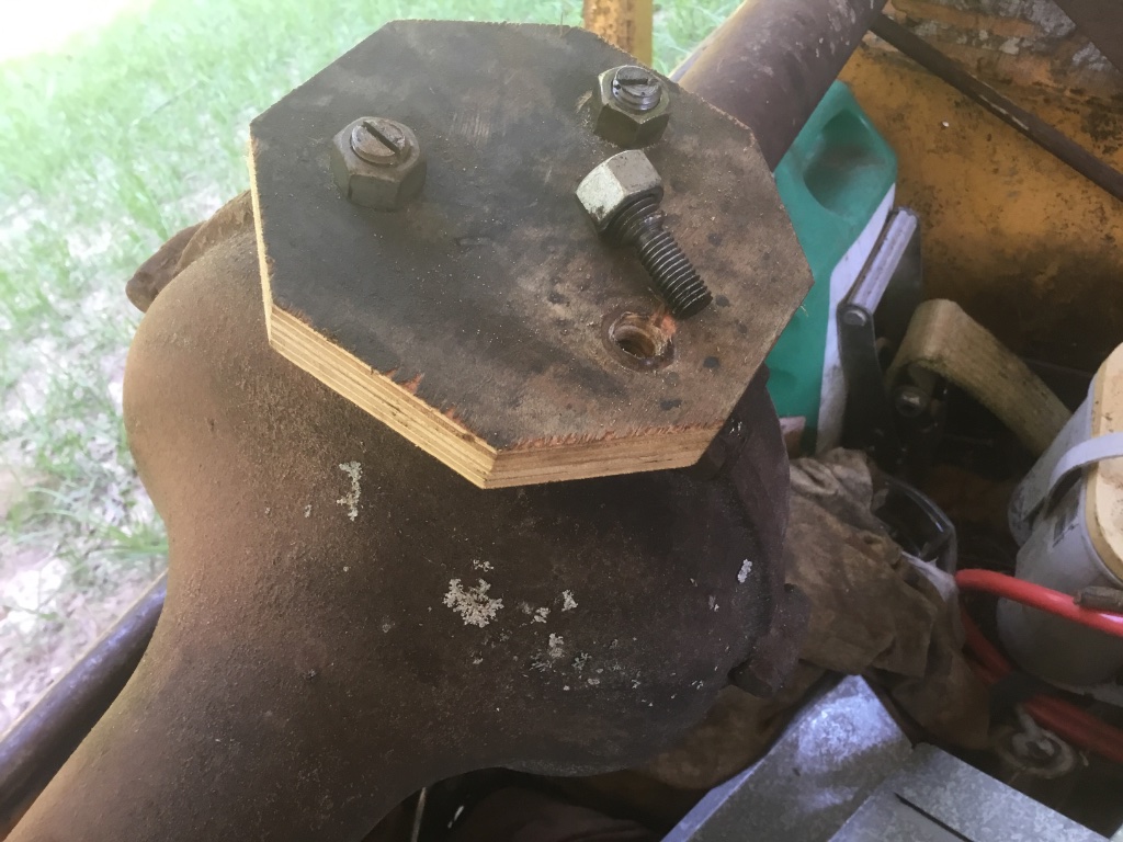

DO NOT CHASE THOSE BOLTS UNLESS YOU HAVE THE CORRECT TAP
[/quote]
Are you talking about the 6 DRIVE SHAFT bolts/studs?
During a proper rebuild those 6 holes should be inspected & threads chased. Along with removing/cleaning the old grease & dirt. Maybe you find that housing crack. As in a motor overhaul, address all threads
[/quote]

Mark is dead-on, the studs are 7/16 X 16 not a common tap or die. .4375 X 14 threads per inch is standard.
Re: Need some help
Posted: Fri Jun 18, 2021 6:42 pm
by speedytinc
That is not correct. Measure them again. The correct thread is 13/32-16 .406 dia.
Re: Need some help
Posted: Fri Jun 18, 2021 6:47 pm
by Scott_Conger
none of the above
13/32" x 16 thread is what was done at the factory.
Anything else is a bastardization of the correct diameter and pitch
And there is now proof that John K types faster than I.
Re: Need some help
Posted: Fri Jun 18, 2021 7:02 pm
by BobShirleyAtlantaTx
I stand corrected.
