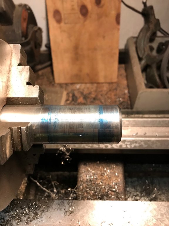

So I did what Kerry suggested. I took some 320 and then 1000 wet/dry sandpaper and wrapped around a socket to get the appropriate diameter and polished the rod. got it pretty good I think. There are a few pits left but there's enough bearing surface to be OK. I measured the crank pin and machined a shaft to that exact size for fitting purposes. With the sanding and scraping done I put some Prussian blue on the shaft and tightened it up. I think it's OK. I measured with Plastigauge and got 0.0015" clearance.

My experience with Timesaver Yellow feldspar compound was an excellent one. I fit new rods to an old crank which had odd diameter (but consistent size/no taper) and after purchasing custom bored rods for that crank, the compound fit the rods to a dead perfect fit over 100% area and .0015" gap.
I really can't speak highly enough about the stuff. It's been around lapping Babbit for over 100 years, and that's it's purpose. It's non-embedding and breaks down to a finer and finer mesh size through use. MFG claims that you don't have to clean up, but I consider that bad practice and invites sloppy workmanship so I clean up meticulously.
Some feel it is a bandaid for "poor work". Really, nothing could be further from the truth. Particularly when trying to salvage a rod such as you're doing.
Only a very tiny bit is used at a time...far less than a thimble-full. There was once a thread where it looked like someone poured in a gallon of grey goop into an engine and a poster declared it was Timesaver and that it ruined everything. No one determined exactly what it was as the engine was an inherited problem. Quite frankly, you couldn't purchase such a volume of the stuff from the manufacturer I think, unless you were a full-blown retailer and poured in several cases of the stuff and simply stirred like it was a cement mixer. I believe that one post soured many folks and that is truly too bad.
