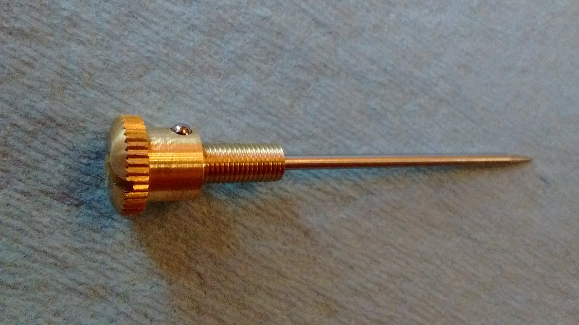

I have an OF body which was sold to me on the cheap because the low speed and high speed needles were missing from it. The only place to get replacements would be from another Stromberg, right? Wrong. I felt that it would be a shame to leave it in that condition and felt there would be no net gain to my stable by stripping another OF to save this one, so I have replicated them. This one is complete and the fuel needle will be completed later in the week once a special reamer shows up via the UPS gal.

not at all
in fact, the long needles are already in stock...just waiting on a special diameter reamer to fit them to the adjuster

Looks like the body has been machined out of one piece and the needle inserted. Is there a rivet that holds it all together? Nice work, very delicate.

No rivets
assembled just like the original
there is some small variability in dimensions on 8 original parts which were inspected, with a couple of dimensions being critical. All my dimensions are tightly controlled around nominal values with small tolerances, which keep variability of the new parts within the population of old parts in hand. Certain critical dimensions are controlled very tightly

New pix of another needle style
The last Strombergs came with machine broached wells and diamond knurled adjuster heads...I think they are a nicer looking part and are easier to grip. Sorry for the terrible background and color... :(

Nice Job, I prefer the earlier style knurl
