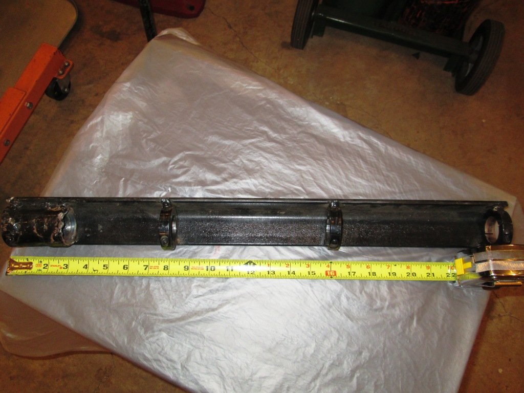

If both the old axles are junk, use a cut-off tool or cutting torch to cut off the gears from the axle leaving a short stub to press against - sometimes I've been able to use a 2 lb. hand sledge to hammer the gear down enough to remove the keepers but you will need a hydraulic press to remove the axle stubs - I have a 30 ton AND a cage I built to prevent the axle from bending. A while back some of the new axles didn't have the keyway machined deep enough resulting in a new bent axle and the manufacture of my axle cage - that problem has been remedied.

I use a 20 ton press. Some axles take all 20. Every rear end I do gets both axles "stretched" lengthened to make up for taper wear.
Put the nut or a nut on to protect the thread. Some axles objectionably flex. I worried about this, but have not seen any with a permanent bend. I do check each axle when done & polish the machined surfaces.
I now have a thick wall tube with a base plate that the axle sits in for the press to minimize the flex.
Its a very simple & easy job. Your shop guy it just lazy & dont want to mess with it. Use a press. A hammer would only destroy.

My press is prone to flexing & parallelograming. A real good press & getting the axle straight may greatly lessen axle flex.

I'm thinking a trip to the hardware store would make for a simple cage. 1 1/4" x 2' pipe & a floor flange. Taking it to your press guy might ease his fears of bending your axle shafts.

One thing I did to prevent bending new axles was to reinforce them with angle iron before pressing the gears on. I cut 1x1 x 1/8" angles to about 22". I wrapped the axles with tape to protect surfaces and then clamped two pieces of angles onto axles with a few hose clamps. Doing this increased the critical buckling force from about 28,000 pounds to 54,000 pounds. The press I used was 20 tons, which could have buckled an axle without reinforcement.
Good luck.
