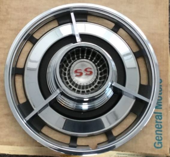

My Daddy bought a new 63 nova wagon for the family. When he was @ the dealership to pick it up. Another guy who had just bought an impala SS was complaining about the clacking of the plastic SS centers of the hubcaps. Dad "helped him out" by trading hubcaps in the parking lot. (by mutual agreement) Got home & smeared epoxy inside to shut them up. Came out way ahead with those 3 spoke SS hubcaps.

Post by ChrisB » Thu Aug 05, 2021 4:01 pm
I said to myself, "Myself, what do those SS hubcaps look like?"
63 Impala SS hubcap.JPG (58.75 KiB) Viewed 2768 times
