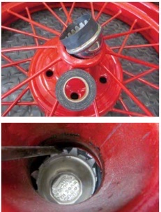

The hubcaps on my wire wheels are somewhat loose.
And by somewhat loose, I mean I sound like Santa's sleigh coming around the corner.
Is there any trick to tightening them up?
Re: Wire Wheel Hubcap Jangle
Posted: Wed Aug 04, 2021 7:34 pm
by Jerry VanOoteghem
You can take the wheels off and bend the retaining tabs tighter. Or, you can stretch an o-ring around the cap, nesting it in the gap between the cap & the wheel hub, and stop the noise for good.

Two minutes with a large flathead screwdriver from the back side solved the problem . . .
. . . after you told me I could take the wheel off to do it. :lol:

I cut pieces of pipe insulation and stuck them behind the caps. Someone on the forum gave me that idea. It is a soft foamy plastic so it just compresses and holds the caps in place. Easier than the screwdriver trick which also works well. You only have to bend about 8 of the tabs to hold it in place. Save the rest for another day.

Suggested by more than a few Model A guys with same issue; The O ring or black silicon. (or what ever color) Few dabs abound the perimeter will hold the cap in place. Like the Model A, don't bend all the tabs over, 4 should be fine.

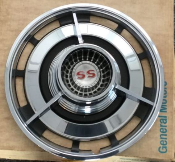

My Daddy bought a new 63 nova wagon for the family. When he was @ the dealership to pick it up. Another guy who had just bought an impala SS was complaining about the clacking of the plastic SS centers of the hubcaps. Dad "helped him out" by trading hubcaps in the parking lot. (by mutual agreement) Got home & smeared epoxy inside to shut them up. Came out way ahead with those 3 spoke SS hubcaps.

I said to myself, "Myself, what do those SS hubcaps look like?"
63 Impala SS hubcap.JPG (58.75 KiB) Viewed 2774 times
