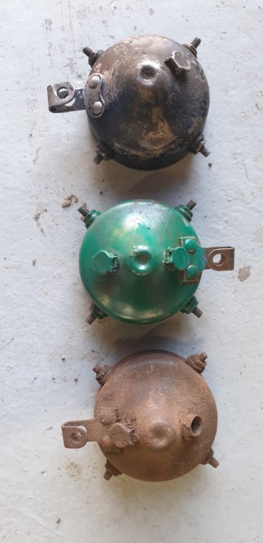

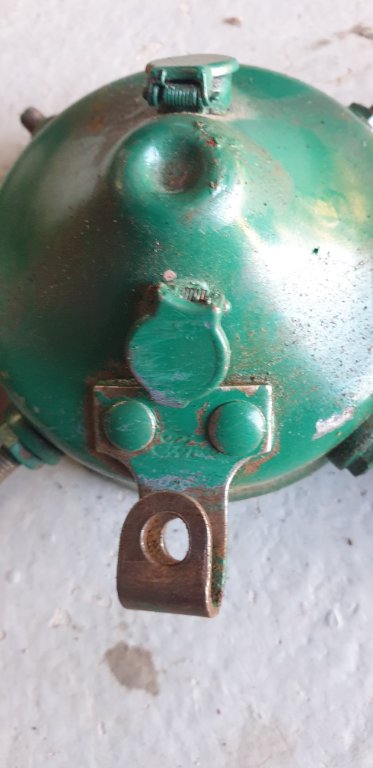

For everyone's reference , here is the timer case that is being referred to. It is clearly marked with the ford script and has oiler on top and bottom and can be used with the timer arm connecting up top on the USA LHD cars and can be flipped upside down and used on a RHD car with the timer rod at the bottom. The inners of any roller timer casing can be removed and the Anderson style contacts installed. not a big problem. Pretty sure the modern day version of the Anderson Timer used original ford cases anyway?

Mark, I presume you have the timer cover you want and then want to have it rebuilt. If you are looking for a cover, there were differences, just as there were in IS timers. Most RHD timers we have in Australia do not have the TWO oilers that allows them to be used on LHD and RHD cars. I do have a cast iron body which is threaded to take two oilers, and the odd pressed steel one also, but most have just the one oiler, opposite the lever. If I can help just email and I will be happy to oblige.
