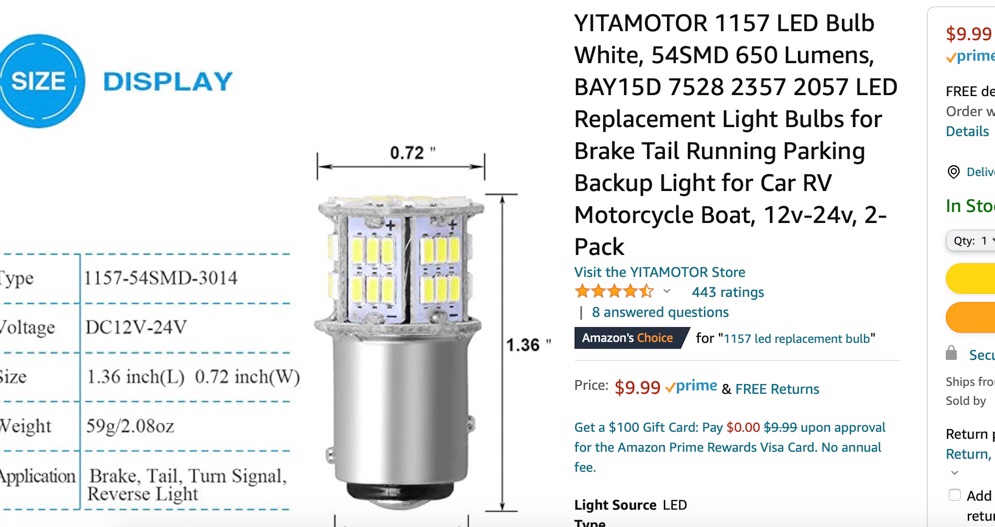

Don’t think you’ll find an incandescent 1157 (tail and stop filaments) shorter to fit inside the housing and lens as they are all around 2” high.
But these LEDs would fit, much lower height and brighter and lower power use!
