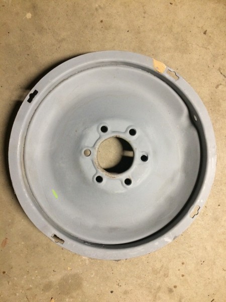

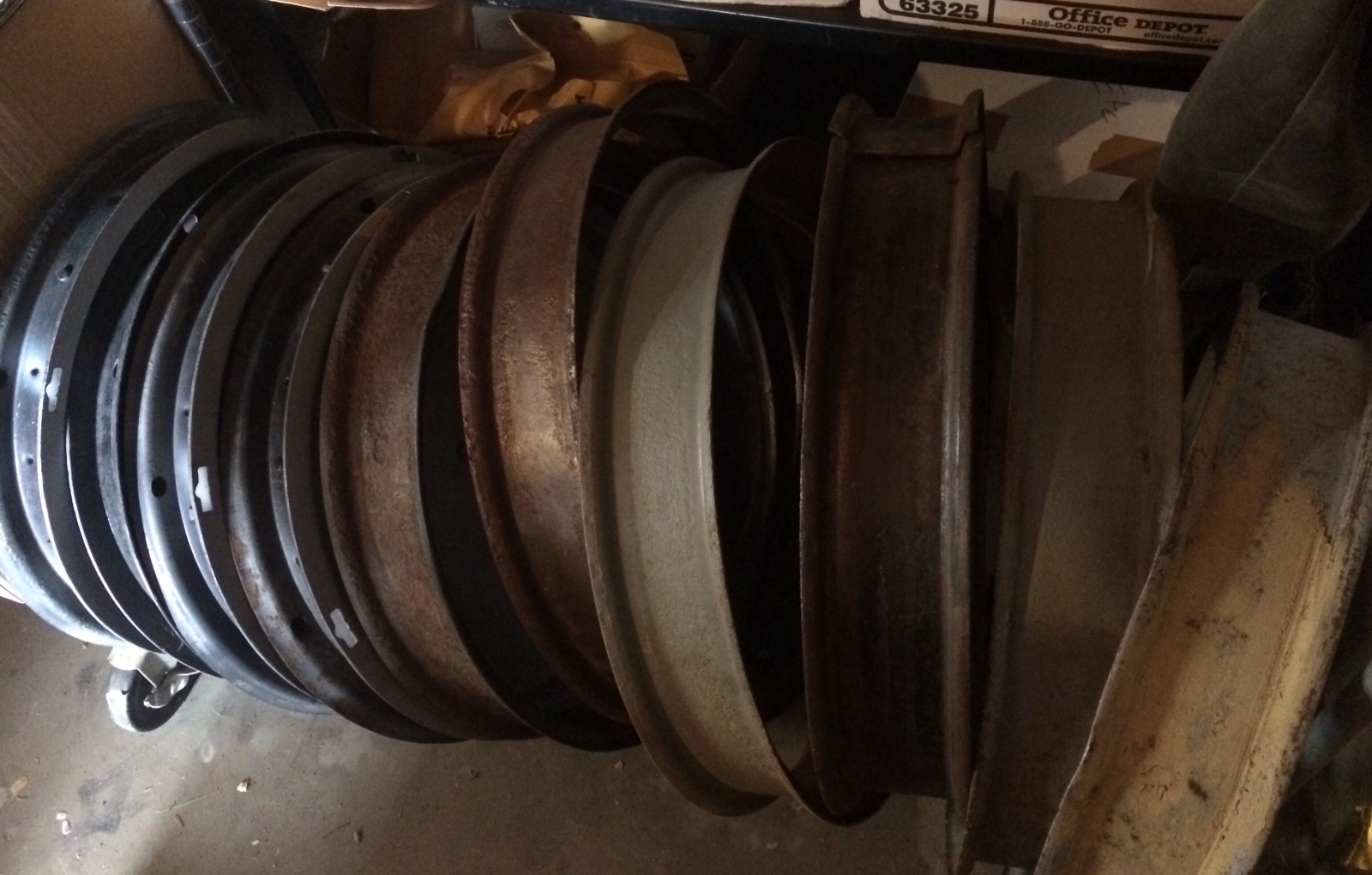

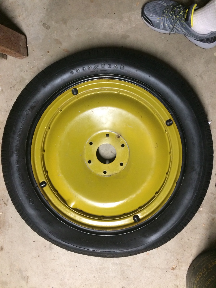

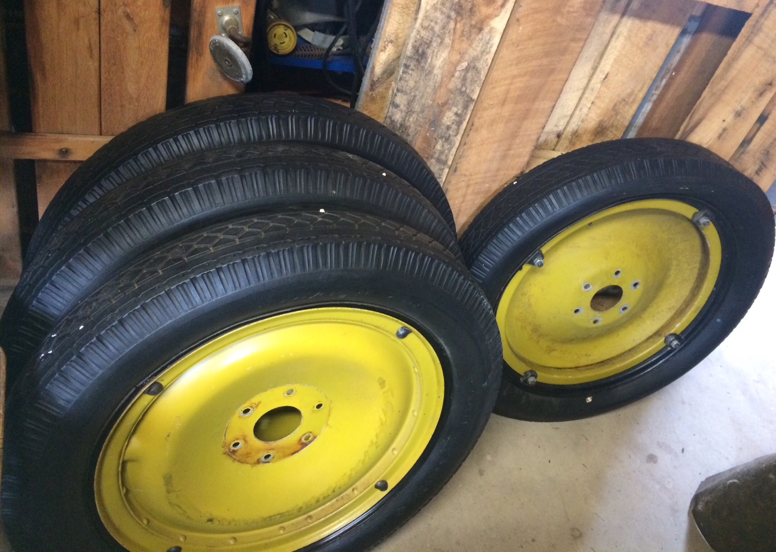

I purchased two sets of disc wheels:
I did research on old forum posts and the yellow type of wheels have been used with regular Model T hubs. Evidently for the rear wheels I will need to have a spacer plate. I would love to hear insight on that.
Any insight on the gray set of wheels?
Thanks,
Matt
Thanks,
Matt

The yellow wheels are ether 26/27 or 28 depending on the width of the rim. I think the sandblasted one is 29 or 30.

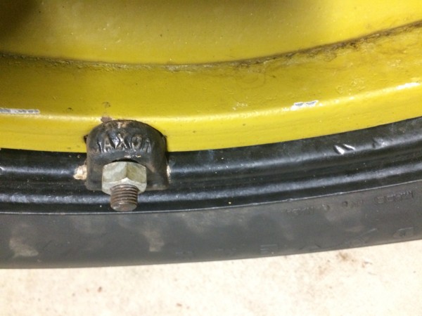

Matt, Back in the 1980's I had a set of Chevy 1925-26 era 4:50 x 21" Jaxon disc wheels, like your yellow wheel, on a stockish Model T speedster. They worked well on Model T wood wheel hubs with careful redrilling to Ford. It did take a spacer in the rear to clear the 1926 style Model T brake drums. The 1925 style smaller brake drum may work with out a spacer, I don't know. They are heavy wheels and after a few years I ended up changing over to 1926 Model T wire wheels and sold the Chevy wheels. They are nice wheels for a low bucks car if you have good split rims for them. The other wheel I think you would want to use the Chevy hub that goes with it due to the embossing at the hub.
- Posts: 4383
Re: Chevy disk wheels
Jaxon was a spin-off of one of the independent wheel manufactures of the late '10s. In the beginning they made mostly wood spoke wheels, then more and more they made steel disc. During the '20s, they mostly provided steel disc wheels for General Motors. Their wheels were used on Chevrolet quite a lot from about '23 up until 1931. They were also offered as an option on Oldsmobile and even Cadillac, although it was a rarely chosen option for Cadillac, I have seen two surviving Cadillacs with Jaxon wheels on them. Sizes ranged greatly from 21 inch diameter down to 18 inch, tire widths from 4.25 on earlier Chevrolet up to 6.50 for the Cadillac. I have seen a few even heavier Jaxon wheels used on the front of early '30s ton trucks.
One of the problems today with Jaxon wheels is that with so many variations of diameter, rim/tire width, and disc to felloe offset, is that putting together something close to a matching set can become quite difficult. About twenty-five years ago, Vic Salla and I swapped wheels around so that both of us got decent sets where both of us before had just a mis-match mess. I still have one wheel left because the off-set on it didn't match any other wheel between us.
On the wheels you show above, the yellow one has the flat center where it bolts to the hub. Those are usually 21 inch wheels. However, some can be found that are other sizes. The gray wheel had re-enforcing ribs around where the wheel bolts to the hub. These strengthened the wheels slightly and helped prevent the development of cracks. Wheels with those ribs are usually smaller than 21 inch. 20 inch and 19 inch are common, and I have seen a few 18 inch also.
So if trying to collect up a set? Measure carefully for size, have a good idea what variation and size you would like, and try to work with a few friends that would also like to get a set.

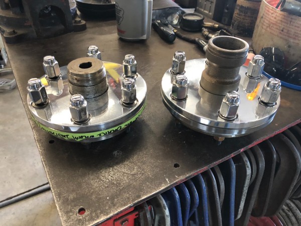

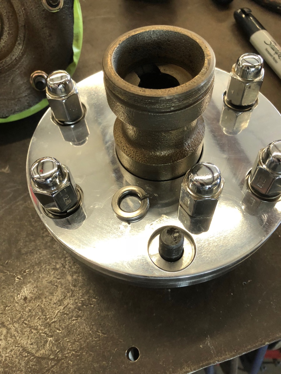

I have been making the adapters for about 20 years. I like the 21” as they keep the gear ration the same. The rims are about bullet proof unlike others. The adapters work best with 3/4” billet aluminum with Model T wood hub pattern and the other side using the Chevy pattern. Making a beautiful 1/4” outside rings for the lugnuts.
They are high on a shelf at the moment.
Hope this Helps.
Hank
Hope this Helps.
Hank

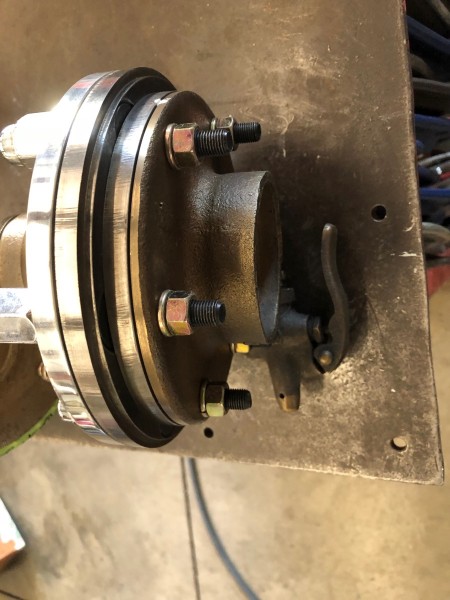

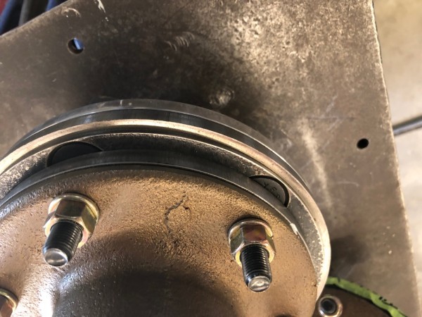

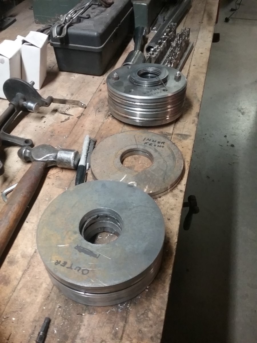

Pull these off the top of the shelf to show how we did it. Two piece adapter for the harden counter sunk machine screws which do the attachment. Will work on everything except the Rocky Mountain Brakes. A wider adapter plate is required.
These are for sale with the hubs fitted, no bearings (1 set) $900.00 plus shipping and insurance, also have just the adapters (3 sets) $600.00 plus shipping and insurance.
PM if interested.
All the Best,
Hank in Tin-A-See
PM if interested.
All the Best,
Hank in Tin-A-See

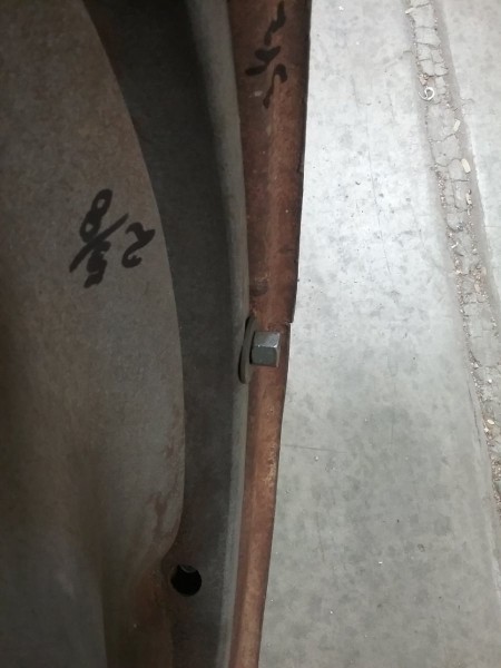

In addition to or to clarify what Wayne said above, the wheels measure 2 1/4 second pic,and 2 5/8,top pic, at the outer flange. The only difference I know of in the rims is the method to lock the split. I have one mismatched 2 1/4 wheel with adapter plates I make already installed. Looking for its three kin...….

Thanks for all the insight on Jaxon wheels. I checked my two sets and yes the yellow are 21 inch (with 4.40/4.50-21 tires). The gray look like 20 inch.

Yes, the Model T hub bolt centers are 5 inches and the Chevy lug centers are 5.5 inch. It looks like the Model T hub is right at 6 inch and should almost cover the Chevy lug holes if I where to mount it that way. I see Stan Howe used the extra plate like you mention in his setup here: http://www.mtfca.com/discus/messages/17 ... 303565191

Well, mine are not all nice and polished like Hanks, I prefer mine painted and use round head hub bolts.
