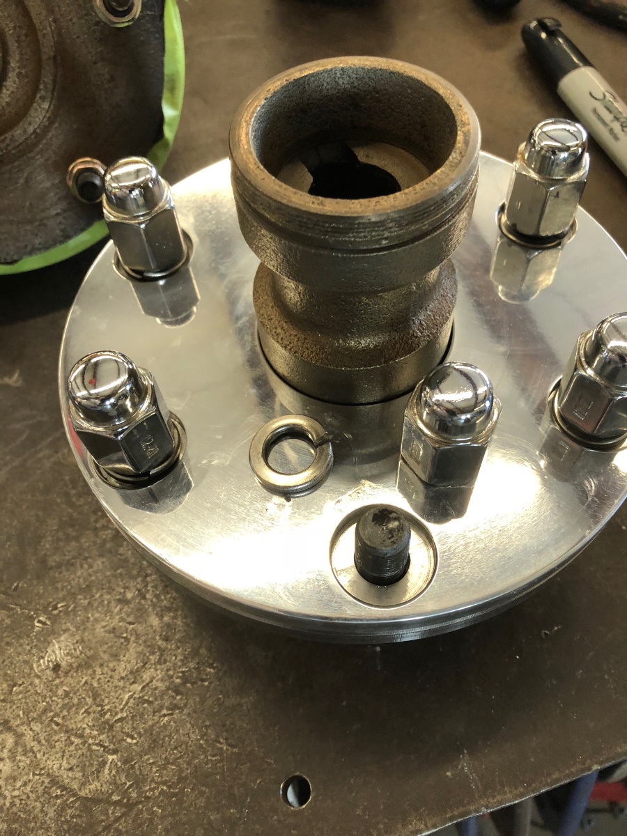

I have been making the adapters for about 20 years. I like the 21” as they keep the gear ration the same. The rims are about bullet proof unlike others. The adapters work best with 3/4” billet aluminum with Model T wood hub pattern and the other side using the Chevy pattern. Making a beautiful 1/4” outside rings for the lugnuts.

Pull these off the top of the shelf to show how we did it. Two piece adapter for the harden counter sunk machine screws which do the attachment. Will work on everything except the Rocky Mountain Brakes. A wider adapter plate is required.
These are for sale with the hubs fitted, no bearings (1 set) $900.00 plus shipping and insurance, also have just the adapters (3 sets) $600.00 plus shipping and insurance.

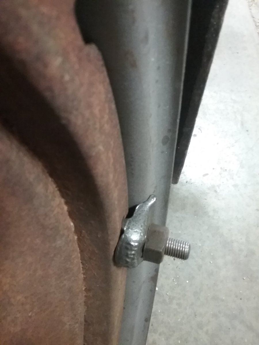

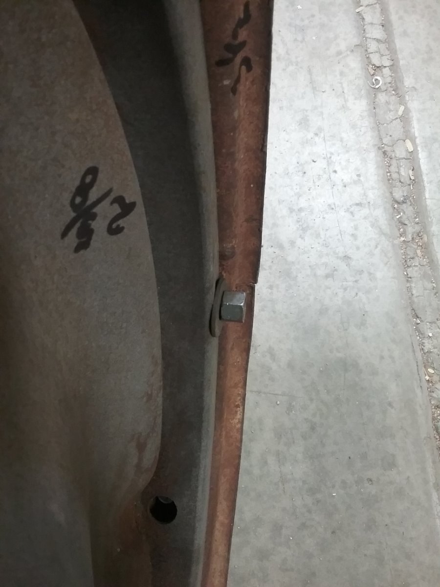

In addition to or to clarify what Wayne said above, the wheels measure 2 1/4 second pic,and 2 5/8,top pic, at the outer flange. The only difference I know of in the rims is the method to lock the split. I have one mismatched 2 1/4 wheel with adapter plates I make already installed. Looking for its three kin...….
