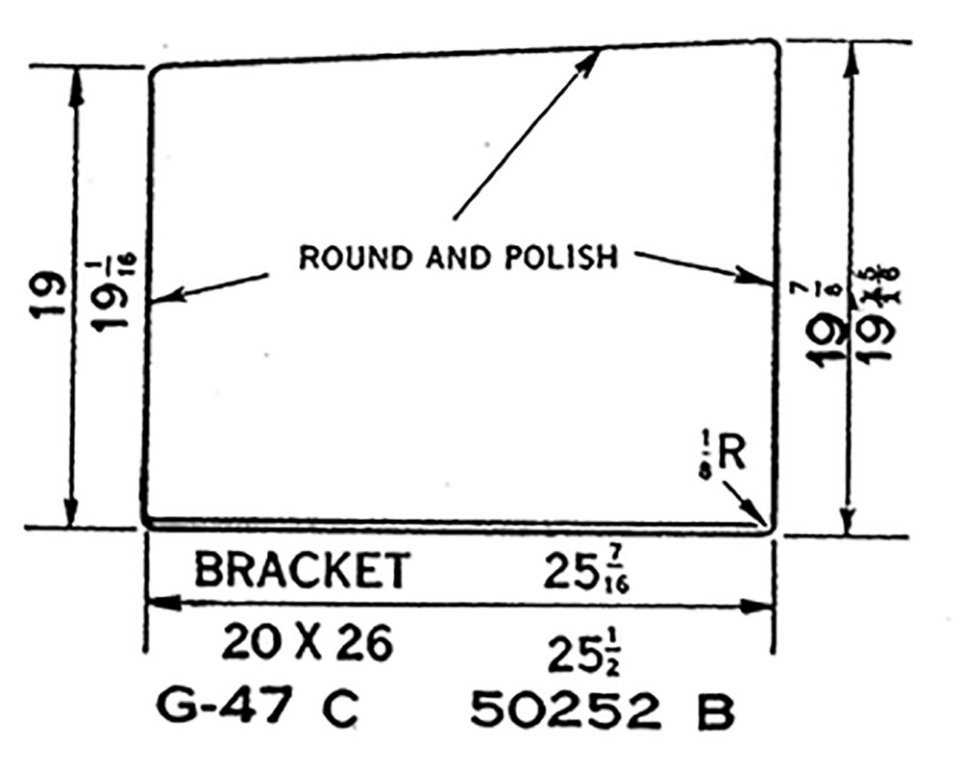

This is from the Ford glass book. It looks like your glass should have been 25 7/16" wide to 25 1/2". 5"off as you say. I don't see any in the book for the width you have except the Tudor glass on the next page of the book. It's heights are wrong but the heights you have are correct for the 26-27 Coupe. Perhaps if he had the book, the page got flipped at some point.
Good luck.

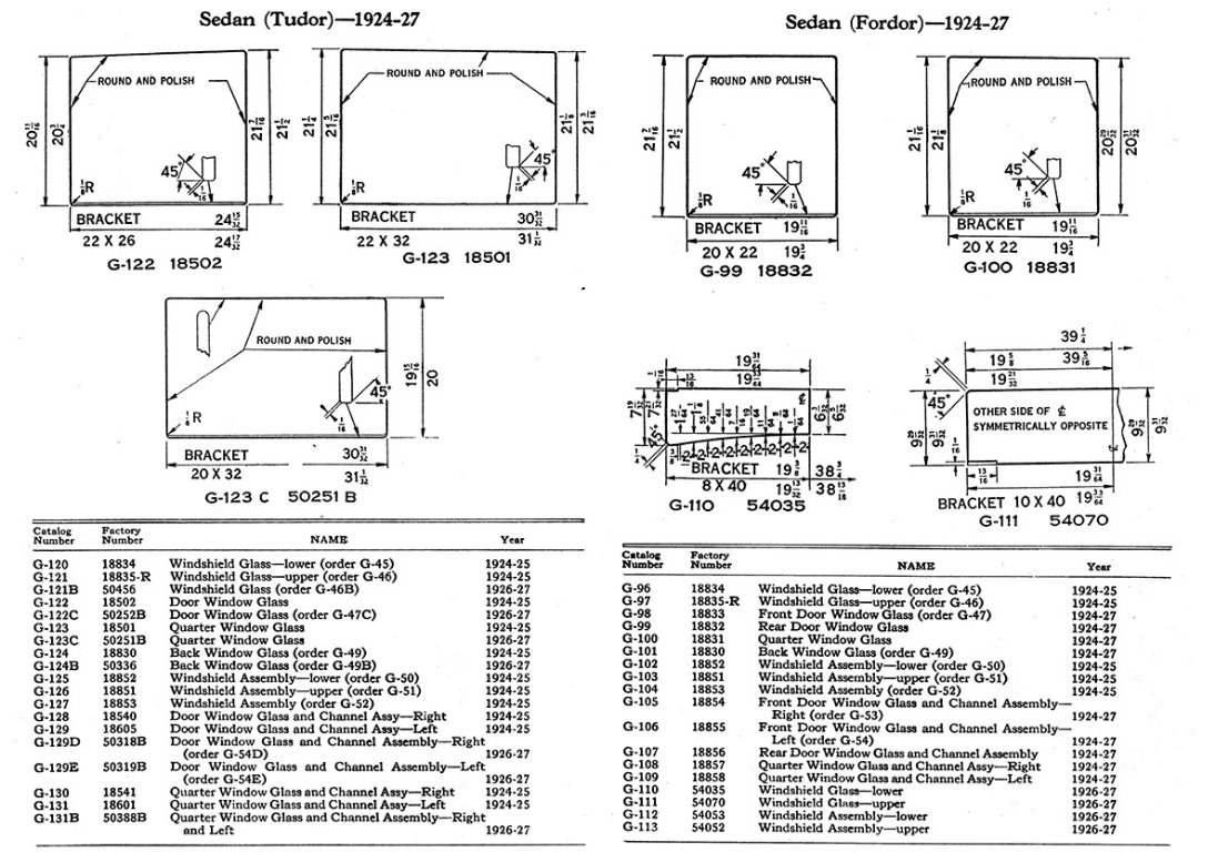

Can anyone post a pic of the diagrams for a Tudor glass set? If this is the only model that the width is correct on, then I must have a couple pieces of Tudor glass. But are these for the DOORS on the Tudor? Or what position do they take on the car?
Thanks!

These include the Tudor and Fordor. The incorrect one I mentioned was for a 22-23 Tudor (centerdoor?) Door Glass which I didn't include here but can if you need it.

I appreciate all the drawings posted!
It appears I have 2 scrap pieces of glass, because they don't fit ANY drawing so far. I assume they weren't paying attention when they cut them, and wound up cutting them too short on width, but OK on the heights. But in any case, I guess I will store them for awhile, until I toss them when I get irritated.
