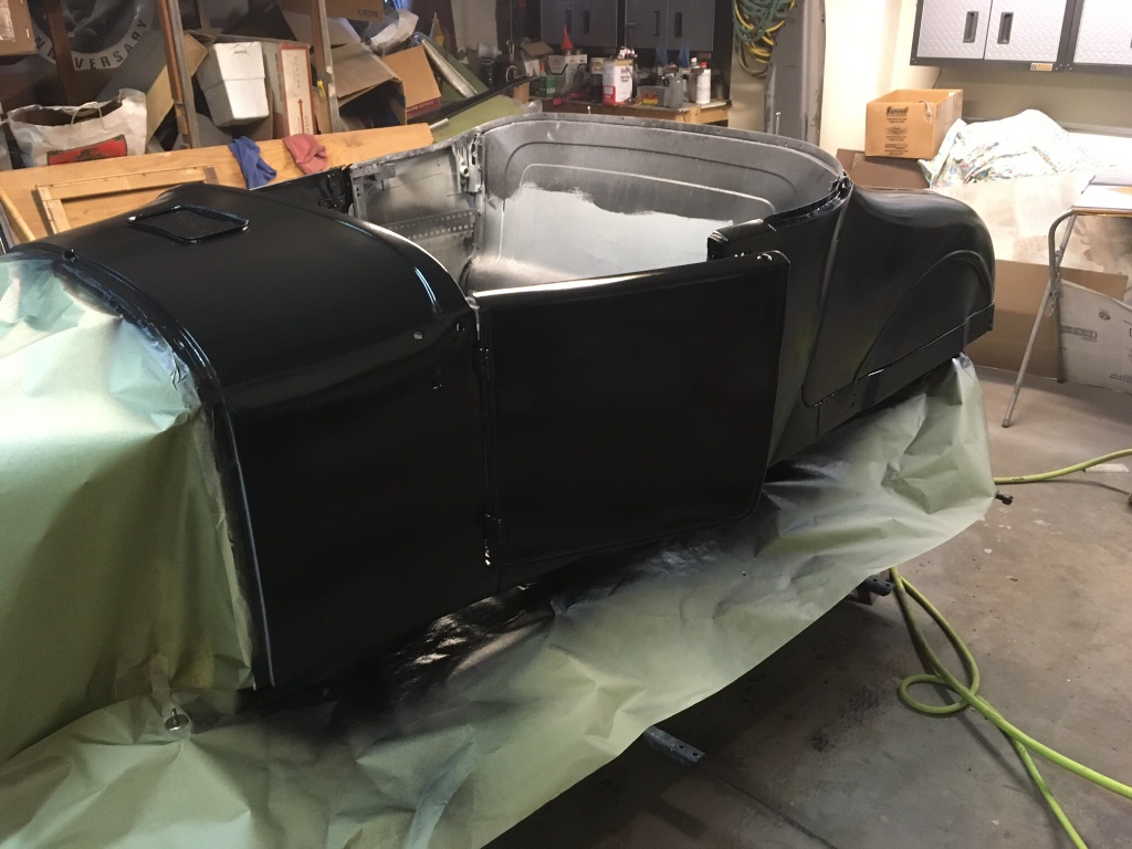

by Myxr6turbo
Here is yesterday and today's progress. Im happy considering it's first spray job.This is before a final rubdown and last coat.
Big big thank you to Luxford for his time on Saturday on the phone. What a wealth of knowledge.
