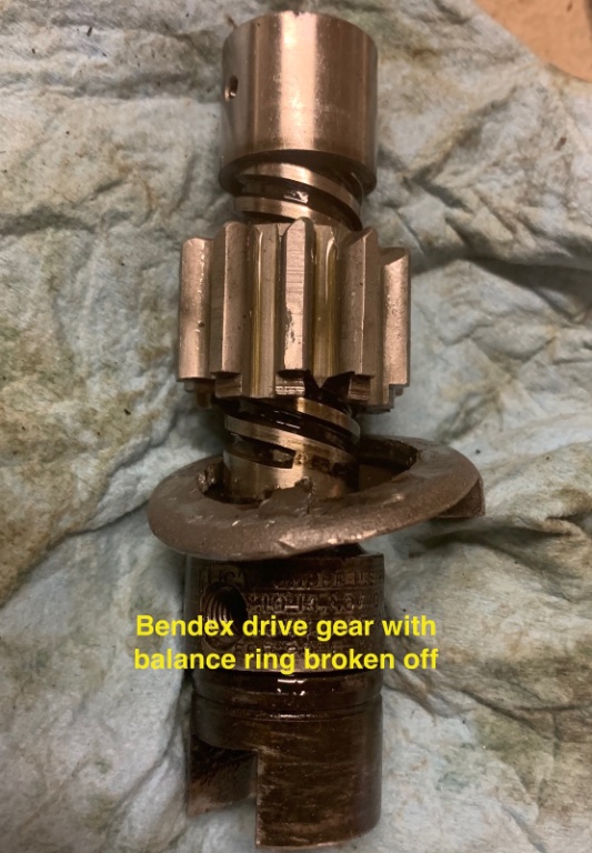

I have been helping a older gentleman getting his T back on the road. It was put away 1 1/2+ years ago following a loud "Clunk" while backing it out of his garage, then pushed back into the garage, and due to health issues there it has sat. While we were attempting to get it going with the electric started the "Clunk" repeated, the starter bound-up, so the effort was stopped. On to the Bendex.
With the Bendex cover removed the issue was clear, a broken Bendex drive gear. Fortunately all the pieces appear to be there.

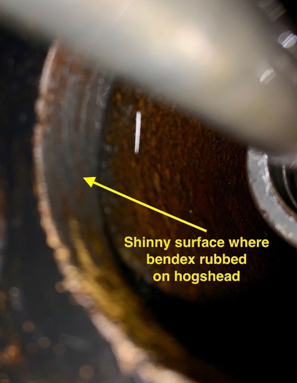

With the Bendex off the starter turned freely but not turning true, bent, and on close examination of the hogshead a shinny surface was see between 9-12 o'clock where the Bendex would rub in passing. (sorry about the out of focus picture).

There is a small pin and a spring on the ring that came off the starter gear. Make sure you put them back, and the pin moves easily before you weld the ring on. You can purchase them from the vendors.
The purpose is to keep the gear back away from the ring gear after it starts.

I doubt all the pieces are there. There is a pin & spring under the counterweight that keeps the gear disengaged back. Obviously it blew apart. You need a rebuilt unit. Its repairable, but is a bit more involved than for here.

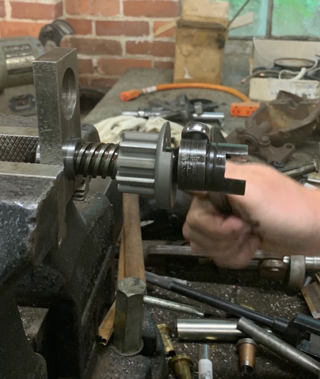

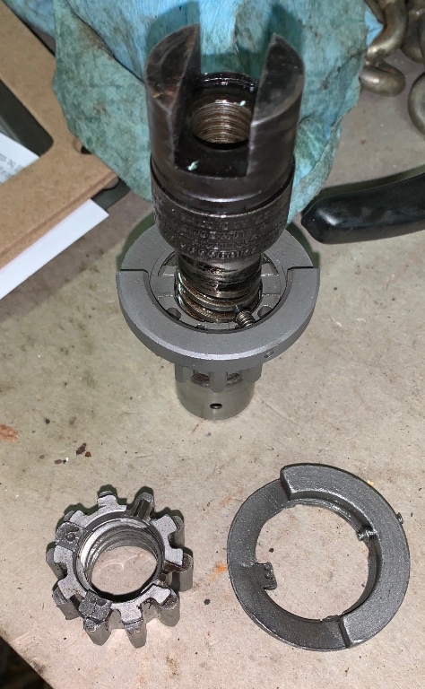

As for the Bendex gear, a new was obtained and installed with the help of Steve at Lang's. All the other parts of the Bendex appears in good condition.
On closer inspection there appears to be one tab, of four, missing from the Bendex gear balance ring and here is hoping it will be picked up in the transmission oil screen.

Once the shaft is straight, slide in the bendix. If it hits on one side, smack it with a brass/copper/lead hammer.Allan wrote: ↑Tue Sep 28, 2021 7:26 pmOnce you have the armature shaft straight, you may well find that the snout on the end casting is also bent. This is somewhat difficult to negotiate a cure. If it is left bent the likely result is a severely worn whitemetal bush in the snout. I have had some success fitting a bronze bushing and then machining its inside diameter, which is a little off-set to accommodate the bend in the snout.
Hope this helps.
It will typically straighten that snout. I slide an extra, loose bendix end cap in to prevent egging the bushing.
