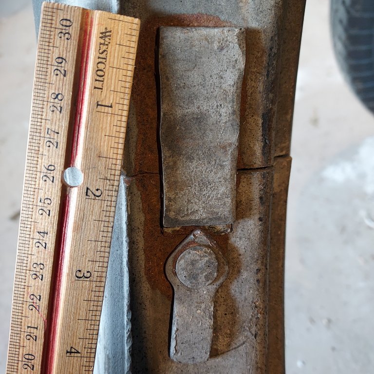

Greetings all!
Am requesting information on firestone split rims. What I need is the dimensions of the clasp which holds rim together. It is two pieces, one is a rectangle and the other is an arrow which pivots on a pin.

Post by Humblej » Thu Sep 23, 2021 2:42 pm
This should help you out. Play with your printer scale to get the ruler to measure right and you will have a full scale template.

No way, printer scale! Can't get it done. Any others have a thought?

Post by speedytinc » Tue Sep 28, 2021 5:05 pm
hah wrote:
Tue Sep 28, 2021 4:44 pm
Scale it manually. Put a measuring device to the ruler shown. Do some division for a conversion ratio. On my monitor the 2" ruler is 2.050" Near enough 1 to 1. So the bar is about 2 3/3 long. The lock is just under 1.75" long
