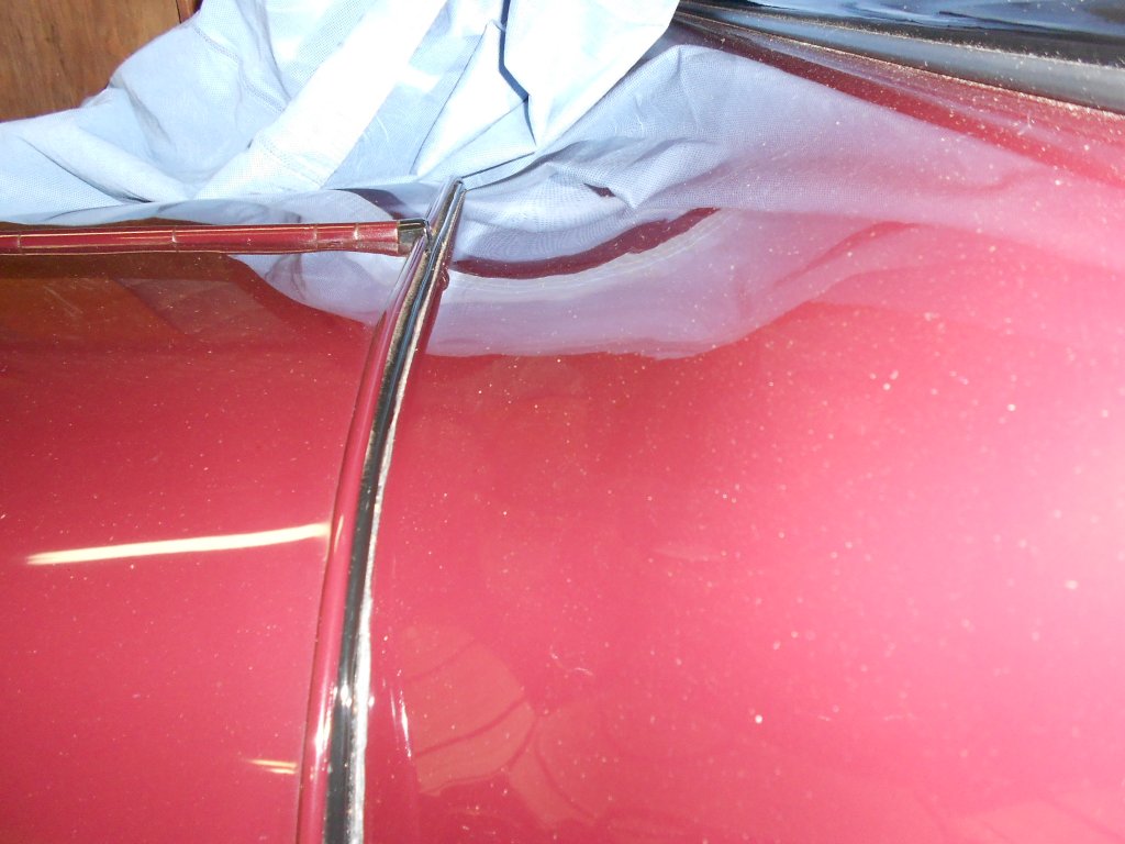

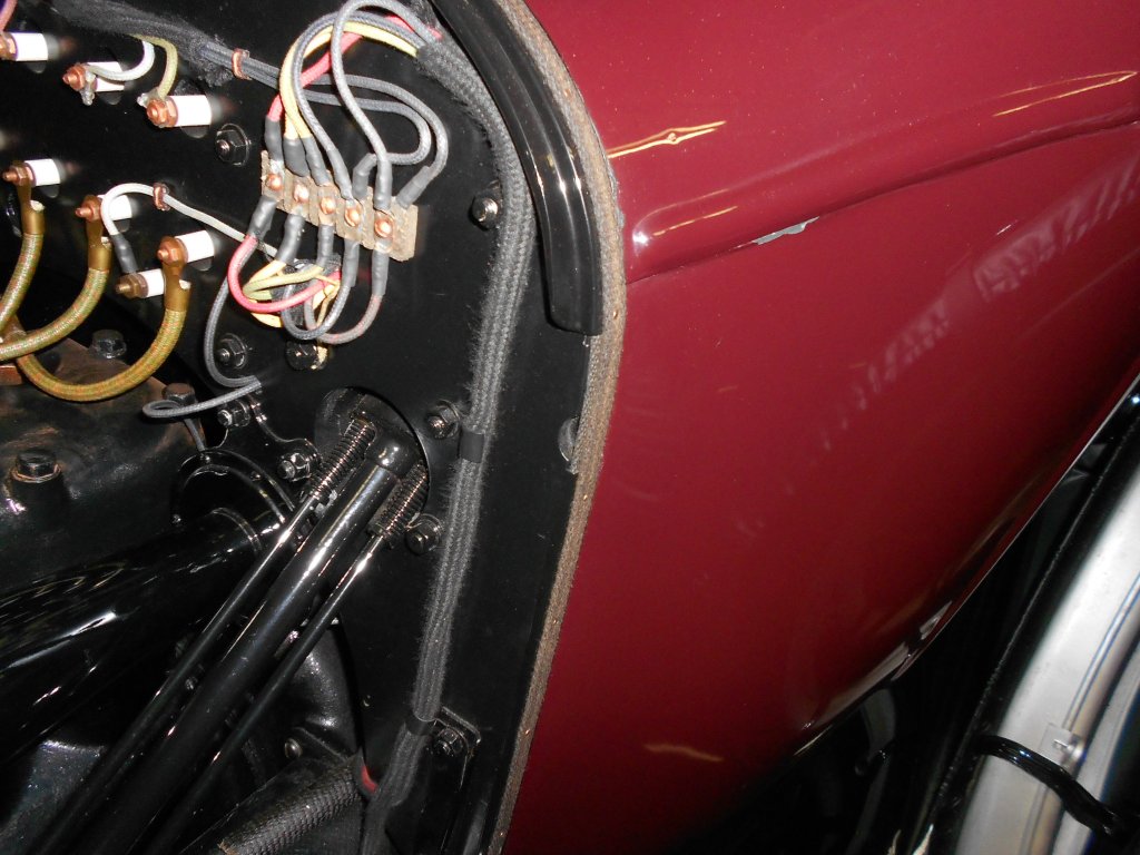

Here are a couple pictures of what I hav. As I said, the top of the firewall appears to be too high and also it serms too wide at the sides. Did they all have the side caps? I dont have a clear picture of begore it was disassembled. Also, is the radiator shroud attached anywhere besides at the two radiator mount bolts? Art

I have a 21 and 22 with wood firewalls. Both have the metal drip rail about 1/8 inch proud of the cowl plus the cowl lace. Also, the sides are about the same. The hoods fit very well front and back and do not rub the cowl paint. Les

Your firewall looks well high to me. Now might be the time to mark it, remove it and trim some off to achieve the same fit as the red car in the posts above.
