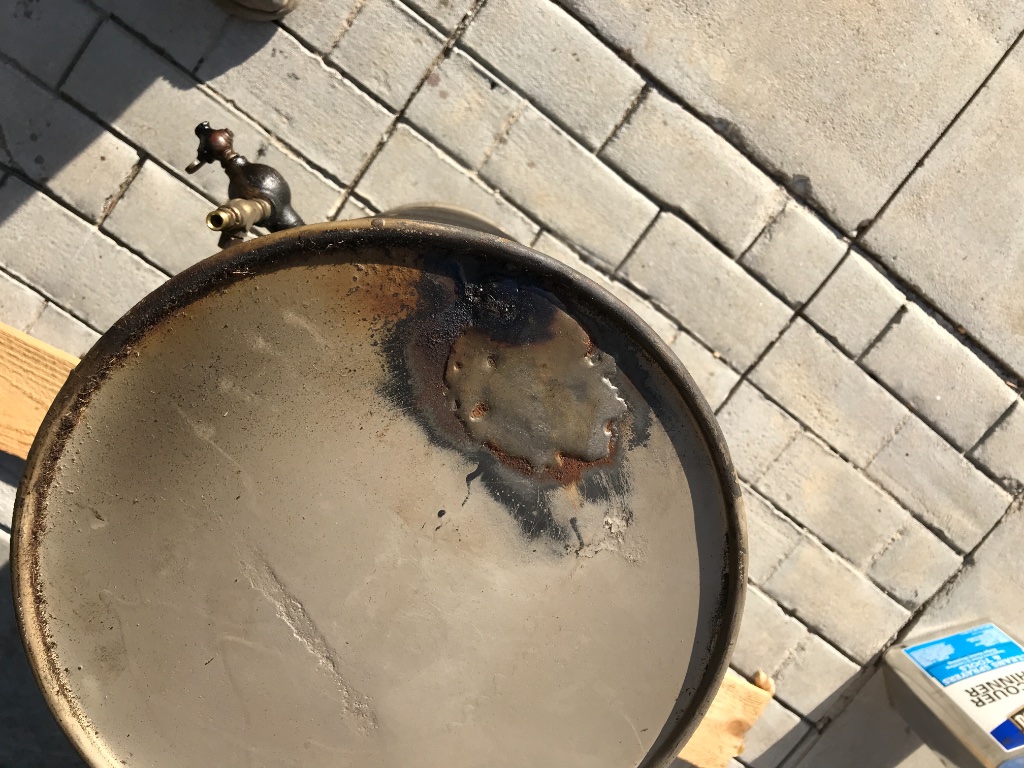

Post by ThreePedalTapDancer » Sun Oct 17, 2021 7:12 pm
While replacing the tank with a nice clean original, glad I did because I found this lovely old brazed patch that was leaking and soon to give way… never would have seen it unless I had pulled the tank
Posts: 7298
Re: How’s this for an accident waiting to happen
Post by Allan » Sun Oct 17, 2021 7:23 pm
Looks like solder to me. Brazing requires far greater heat and a flaming torch. The heat would likely melt solder sealing the end of the tank to the body, and the flame would likely create explosive issues if the tank had been freshly used before the repair. A hot electric iron or a plumber's iron would solder that leak without either of the two risks, provided that the area was clean and tinned properly. A new tank solves the problem, and maybe some others, like rust, sediment and flaky sealing treatments.
ThreePedalTapDancer
Posts: 1736
First Name: Ed
Last Name: Martin
Location: Idaho
Post by ThreePedalTapDancer » Sun Oct 17, 2021 7:31 pm
You might be right, I just glanced at the brass colored repair and assumed it was braze, it may be just rust and fuel discolored solder. But it’s not up to my standards of repair for a fuel tank either way and will go into storage for now.
