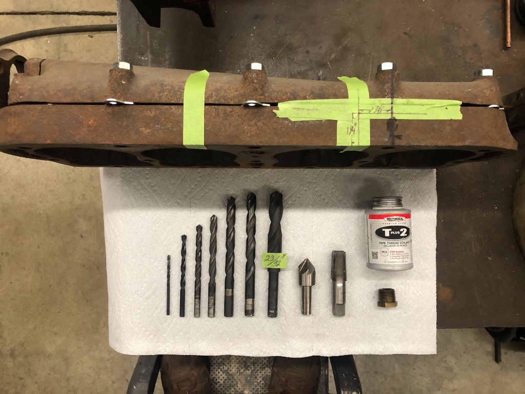

First try was with the Model A inlet that has the thread port. But that only read the cool motor :shock:
water temp forum.jpg (69.11 KiB) Viewed 4258 times
Then mounted to the upper outlet, that let the meter read correctly.
At norm temp when running at tour speed, not fast.
Fuzzy photo from running.
But at extreme speed, running with the modern traffic on 4 lane, likely doing 45mph + , the meter showed the work the engine was doing, generating a lot of heat from those hot pumping pistons :o
IMG_6882 (500x375).jpg (106.39 KiB) Viewed 4258 times

I installed a temperature gauge in the water outlet on my speedster very similar to how Dan did his. I had an old aftermarket water pump housing similar to a Nims pump. It was missing the shaft and impeller so I tapped the hole and installed the temperature bulb. Seems to work well.

I drilled & tapped the rear freeze plug (or whatever folks call them) for 1/2 in. pipe on my Racer for a mechanical gauge works great !
