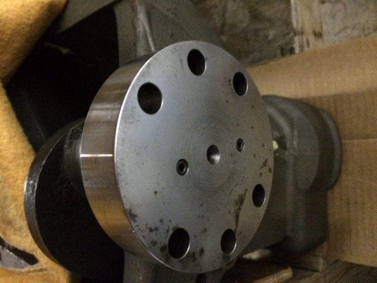

My “No Welding” method. This has been successfully used. The new flywheel hub is made of 4140
I see 2 set screws. There must be more magic involved. More than a press fit?
Re: A Crank in T. Practice
Posted: Fri Oct 29, 2021 7:15 pm
by Les Schubert
John
It is a tapered shrink press fit. The set screws are just for a added safety factor.
The hub is heated to 500 F and pressed on. When cool it is machined all over
