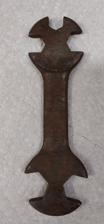

I have some tools from tool kit that are rusting. I would like to protect them and make them look original. Did they come from the factory parkerized, or some other finish?

I wonder if they had the same treatment as the raven finish nuts and bolts, and then I would wonder how they did that too. Anyone know how bolts got the raven finish? Getting a tool red hot and quench in oil will make it turn black. I will try that on one of my surplus wrenches and report back.

This was a fun experiment. I took a rusty wrench, lightly went after loose rust with a wire brush, heated it with a rosebud torch until it turned a dark red color, immersed it in engine oil, and success, rust gone and a nice black finish.
