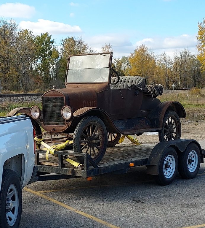

Re: How Tiedown a Model T to Trailer
Posted: Sat Oct 30, 2021 3:23 pm
by Humblej
Thanks everyone. Some very good suggestions. I am now trailering my new to me T home. Did the criss cross straps method with the front wheels against the Jelf stop. Speeds below 45 mph. Floor boards and seat cushion removed, and top down and tied up.

by Humblej
Baloon tires were not an option in 1924, and the roadster pictured on the trailer has 30x3.5 clincher wards riverside tires.
