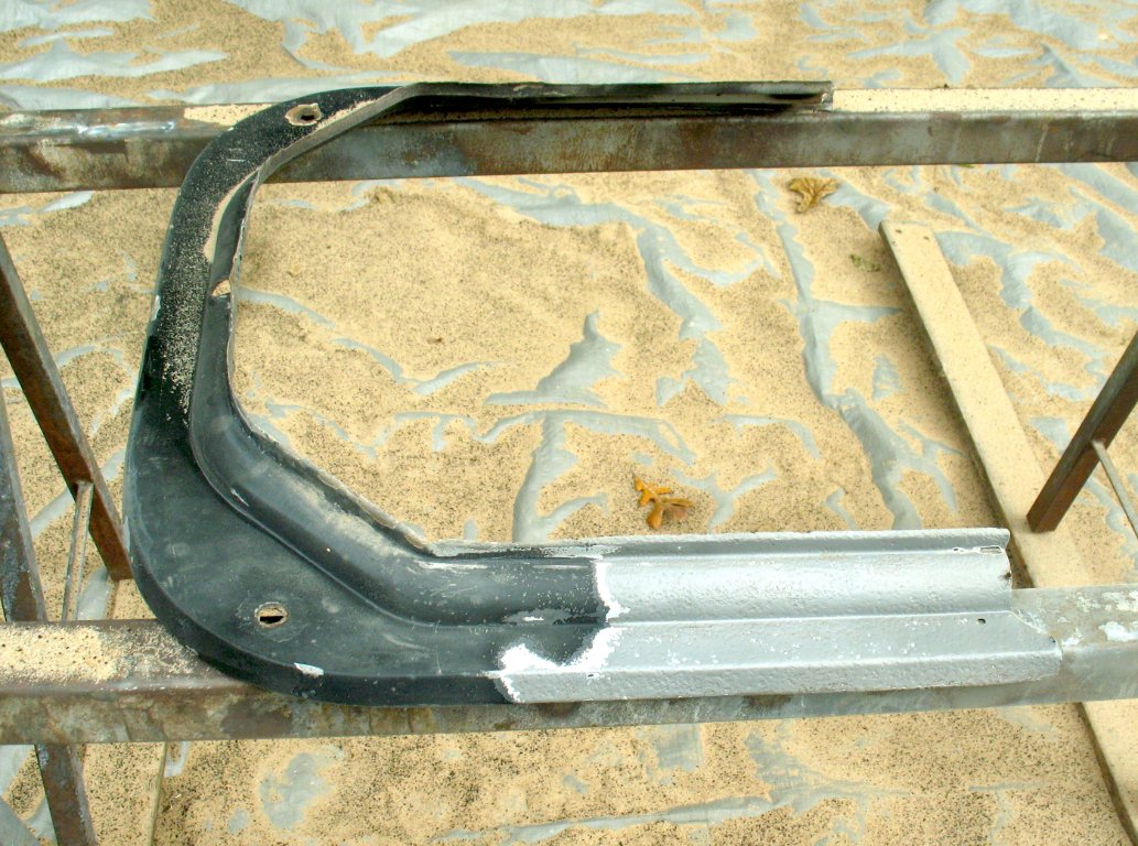

by Steve Jelf
Got started on blasting my hood former. The paint was easy, but the Bondo under it was mighty slow going. I finished about two thirds of the front, and should be done with blasting tomorrow, weather permitting.

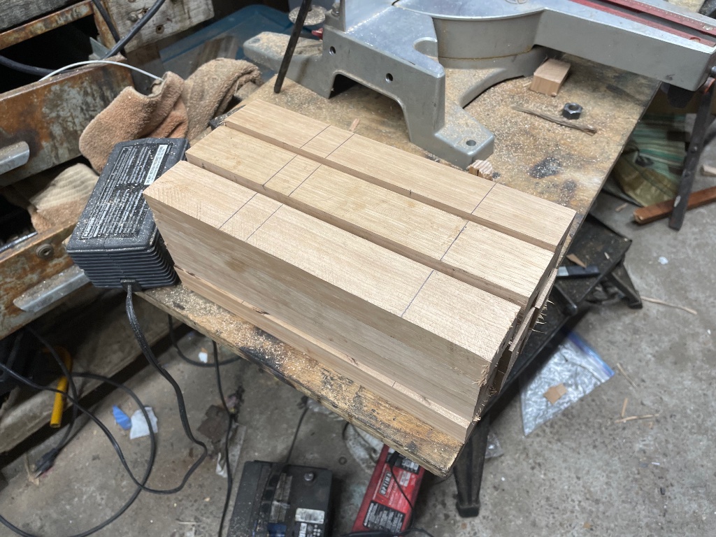

Some of wood spokes on my 1924 Coupe were on the car when I bought it in 1976, some 45 years ago and have done many hard miles. One rear wheel I particular is getting very tired. So I made the decision to respoke the wheel. I could have bought spokes from one of our valued supplies but I decided to do them from scratch.
I purchased a chunk of hickory and cut it into twelve pieces.
Twelve bits of wood
Twelve bits of wood

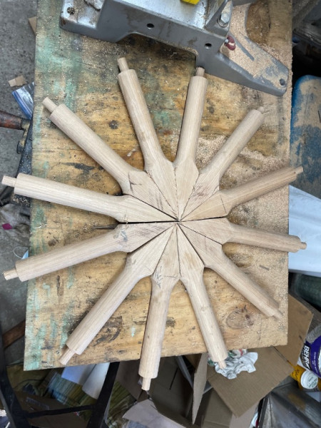

Next was cutting the 15 degree angle at the center of the wheel. Fortunately I found my simple wood fixture that I made when I had the barn in Ramona, it didn’t get thrown out during downsizing. So all I had to do was to adjust the length as it had been built for 9” spokes. Now the twelve spokes should complete a circle.
Spokes in a circle
Spokes in a circle

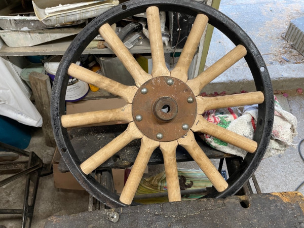

The final step is to press them into the feloe. For this I use a simplified version of the Regan Press, just a few 2x4 and a 1/2” threaded rod. Initially the spokes wouldn’t press in as they were fractionally too long so I trimmed off about 1/16” from the part that touches the hub. The second time they went in with a nice “click”.
Wheel with spokes and hub
Now I have to find a Rocky Mountain brake drum and do a little painting. I’ll probably use the existing drum from the car so the switch over will have to wait until the Christmas tours are completed.
Making spokes almost free hand is very, very time consuming, so I have abut 15 hours in that wheel. However it feels much better than sitting in front of the tv😊

Very impressive job. I seems like getting the fit on the taper just righta and at the same rime getting the right fit at the hub OD.
I wish I lived nearby. I do woodworking, but making spokes is probably beyond my capabilities even though I would like to give it a try.

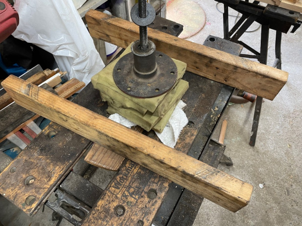

I made my first few spoke from an old length of 2x4, it easy to cut and costs virtually nothing. That how I came up with the fixtures. Ill post a few pictures of the tooling, it’s very simple and takes time. My methods are simple and slow, I’m sure the professional workers would say I’m on the road to bankruptcy if I did it for money.
This is my press
Spoke press
Spoke press

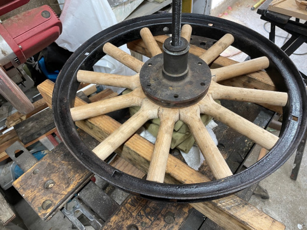

This shows a completed wheel in the press
Wheel in the press
Wheel in the press

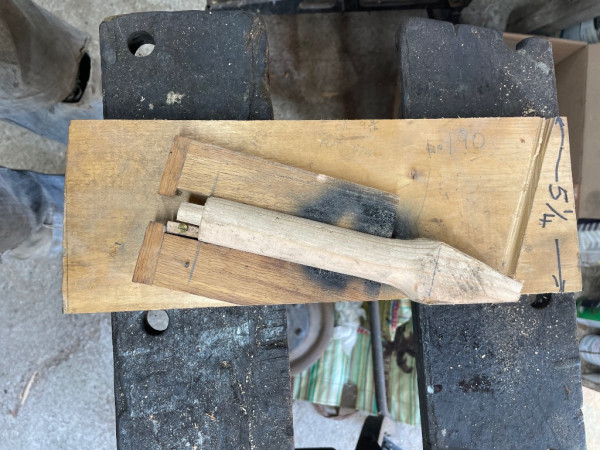

Tooling to shape the spokes
Tooling to get shape and length
The spokes for the 4.5” tire wheels are 8 9/32”long and those for 3.5” tires just over an inch longer. The shorter spoke is one of my experimental versions made of pine, so easy to work. Previously I had used white oak which is as strong as hickory but not as flexible. When oak let’s go they shatter whereas the hickory is more flexible. Again the oak is easy to work compared to the hickory which tend to tear in the lathe. Yes I sharpened my tools before I started.
