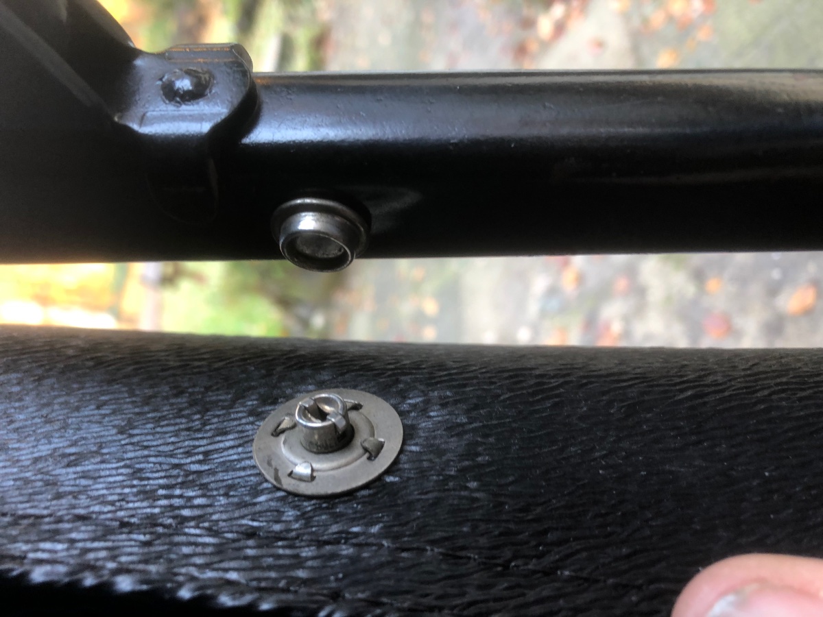

I bought side curtains from Lang
Looks very good and fit also very good
Can someone tell me how the origional connection is of the backpart of the side curtain
I have this on my T
The clips are round and aprox. 11mm in diameter
The rear side curtaine should be between
Bert

by Original Smith
I'm glad the pictures of original side curtains were posted. As you can see, they are different from Carters. Also Ford did not use lift the dot fasteners.
They used Anzo fasteners, which are getting difficult to find these days.

by Jim, Sr.
Even though this NOS side curtain is labeled for 1925, I think that it is actually for 1926-27 roadsters. The "sockets" that are installed inside the rear top bows on 1926-27 roadsters and tourings must have the extra lip to project through the grommets on the rear side curtains. ( I think Larry Smith identifies these as ANZO fasteners.) A similar "socket" without the lip is used on the body panel between the doors on 1926-27 tourings and also on the doors of most 1927 roadsters and tourings. If you use the socket without the lip on the inside of the rear top bow, the fasteners that are crimped onto the rear curtain will not snap into the socket when the side curtains are installed. That lip is to allow for the thickness of the grommets in the side curtains when it is "sandwiched" between the top bow and the rear curtain where it wraps around the back and fastens to the top bow. I think this type fastener is only used on the 1926-27 Model T's, but maybe it was used on Model A's, too. I don't know. See the photos of the sockets an how the grommet fits snug on that lip. The grommets have to be installed quite accurately in the side curtains to match the sockets.

by infotfordnl
Thanks, now I know mine are origional, but who can deliver me this round holes Parts? The rings
Lang?
