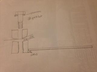

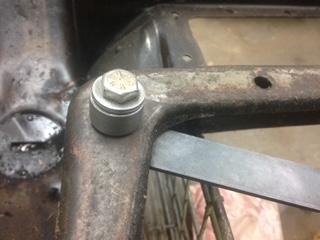

This is a tool I made to flatten the dimples in the pan from multiple attempts to stop leaks. It can be used when the hogs head is off.
dimple tool #3.jpg (12.54 KiB) Viewed 3973 times
dimple tool#2.jpg (13.25 KiB) Viewed 3973 times
dimple tool.jpg (4.82 KiB) Viewed 3973 times
Craig.
Re: Setting the hogs head
Posted: Mon Nov 15, 2021 12:08 pm
by speedytinc
Great idea. Smart tool!
