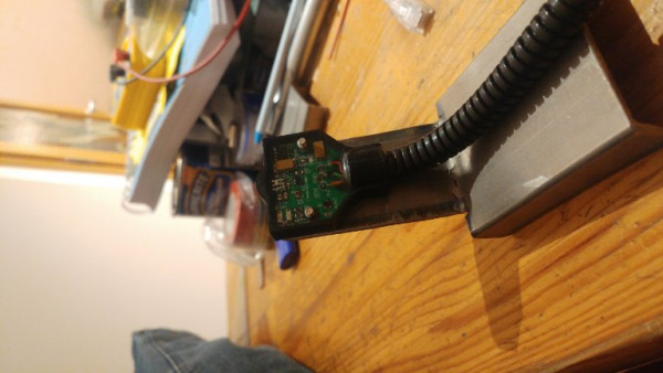

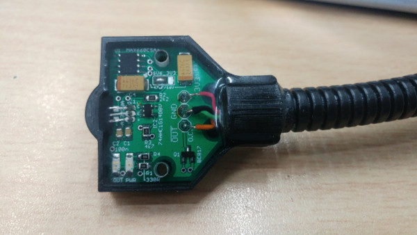

This is my self-built sensor. It has some electronics inside to make it extremely resistant against EMI.
My sensor
My sensor

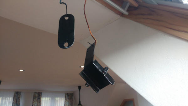

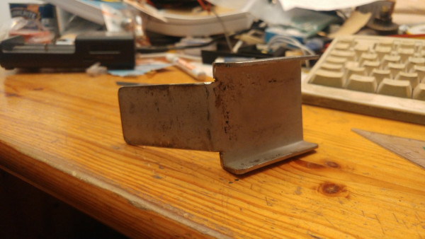

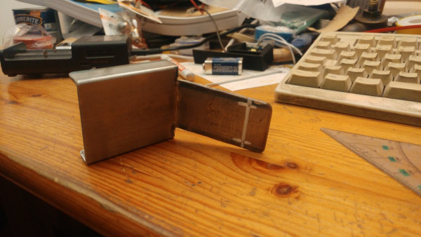

Today I finished the holder for my wheel sensor. It is made of stainless steel and finally painted black.
This is the rough cut&bend of the holder. It perfectly slides over the radius rod with only a very little play. The sensor mounting holes are already marked but not drilled. Long-nuts for clamping are not welded on yet.
Holder cut&bent from 50x30x2 mm rectangular pipe
Viewed from other side

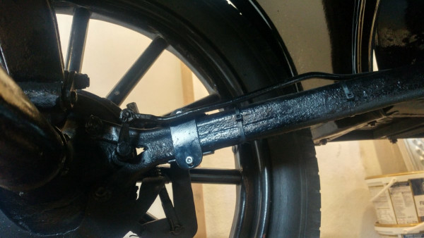

Here the paintwork is drying. You can see the M5 long nuts for clamping the holder to the left-rear radius rod. The cable runs along the radius rod to below the battery, then it goes up in a bow and is fixed at the battery holder. There it has a waterproof plug to allow removal of sensor when needed. The cable is then running inside the left steel frame to my little dashboard.
Painted black
Painted black

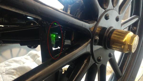

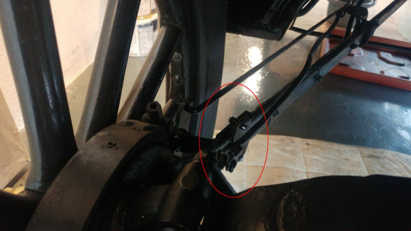

As promised, I want to share a few pictures of my finished Speedometer. The wheel sensor is mounted and connected to my dashboard. It is too cold for a test drive, but I moved my Lizzy in my garage to test. It perfectly works.
The sensor has two little LEDs inside. Green is the PowerLED (permanently on when battery safety/main switch is on, red is the TriggerLED, sitting besides the green one. I love LEDs, they allow easy control if everything is working properly. If the LEDs are irritating I can use a piece of black tape to cover them. The TriggerLED goes on when the magnet stick (inside one spoke) is detected. You see absolutely nothing of this magnet stick.
Left rear wheel from outside
This is a view from the rear to the left wheel. As you can see, the sensor vanishes between all this rods and levers.
Left rear wheel from inner side
This picture was taken from below the car. Here you can see the second half of the sensor holder.
Left Radius Rod where the sensor is mounted

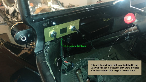

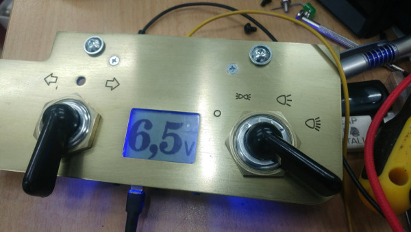

Of course, I can show pictures of my dashboard, but I only have a few ones at hands. I primarily took this pictures to have them at hands in my office (so I could look for some details there, because the car is 50km away). But you can see how it looks like.
Here you see the finally mounted dashboard.
This is a picture taken at the very beginning of my restoration work, therefore the rest of my Lizzy is still very unfinished. But I think this shows better where my cables are running. The wires from dashboard run along the wooden body (inside the black protection tube) down to closely above the flange of the steering column. There they cross the firewall, and end in an old looking fuses-box with six Torpedo Fuses. From there the cable trunk goes down till 2" above the starter. There I made two additional holes through the firewall. The reason is simple - keep cables away from engine so the engine can be pulled without complications.
Finished install of dashboard.

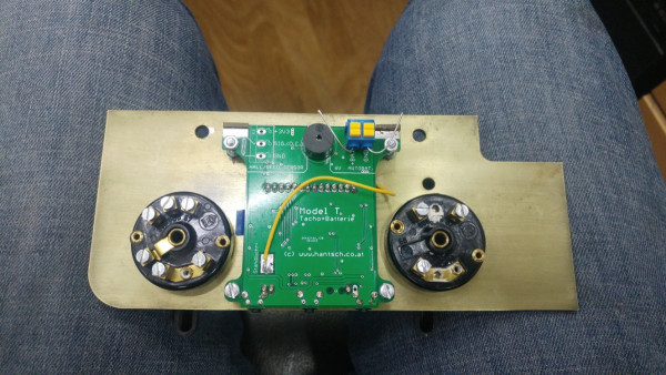

This pictures show the dashboard before it was finally mounted from front and back side. (The green LED above left switch is missing.)
The upper part (where you see the countersunk head bolts, including them) is hidden behind the windshield holder. Also 1/2" of left side is hidden behind the body. It is there to stabilize the dashboard. From this point of view the dashboard appears lots bigger than it actually is. It is in brass, so it matches the overall appearance very well.
The dashboard laying on my working desk
Dashboard from back side (without wiring)
Here is the oldest picture I found.
Of course, my bolt heads are painted black now. I had to drill a second hole for the right bolt, but actually it looks lots better now than ever before. This ugly chrome switch (must have been installed in USA because direction lights did not work as needed in Europe) on steering column is replaced by the left rotary switch on my dashboard (direction lights), the pull switch is replaced by the right rotary switch (Off - Position Lights - Low Beam - High Beam).
New dashboard mounted besides of old switches from former owner(s)
Little remark to the first picture:
On first picture you also can see my self-made "inner choke lever" right of the coil-box. I removed the original headlight switch for it, it was brutally painted over in black by the former owner and had no function at all. The choke wire was running through the same hole as the gas mixture adjustment rod, it was extremely ugly. I re-used its hole to insert the 3D-printed and brass painted panel and handle. On engine side another lever is mounted. From there a nicely bent wire goes down to the carburetor.
Re: Can I safely open/close this bolts without wheel removal?
Posted: Mon Dec 13, 2021 12:16 pm
by rainer
Steve Jelf wrote:
Sun Dec 12, 2021 1:47 pm
You can test at road speeds by running the car with that left wheel jacked off the floor. But the test of survivability will be in actual driving.
Doing as you suggest will cause a double speed display because of the differential and one wheel not rotating. :D
In addition, this can be done lots simpler and without getting a CO poisoning in my garage, as follows...
I jack up the entire rear axle (I will do that after Xmas because then I have four nice little car stands, one at every wheel.). Then I simply turn one wheel by hands. The other one will turn then in other direction and I do not have to work against the stiff oil inside the High Speed Clutch.
Usual travel speed is ~50 km/h (= 30 mph), the circumference of one wheel is ~2 meters, so I can do the math:
Roughly 416 rpm (or ~ 7 turns per second). -- A little bit sporty, but possible.
On my working table I only moved the magnet over the sensor (had only to move it 4 inches out of my wrist), here I managed to get 99km/h (~61mph) displayed. So the maximum speed will be no problem, only calibration needs to be verified. In spring I will drive with GPS (on my phone) and compare measurements. In worst case I have to change the calibration value in my firmware.
