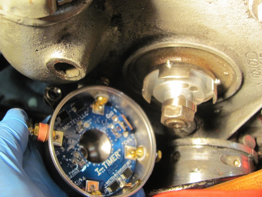

My Flivver came with an original roller-timer and it caused no end of trouble. Unfortunately, I, being a newbie to the hobby, didn't know enough to point an accusing finger at the true culprit and whenever my engine would misbehave, I'd wind up shipping coils off to be tuned, replacing the ignition harness, cleaning and re-gapping spark-plugs and taking apart every accessible ignition component to clean and polish all the terminals. On one occasion, a friend came in from out of state to help me diagnose my balky engine and did a compression check which, unexpectedly, turned out perfectly normal. From all appearances, the timer seemed okay, but out of frustration, and not knowing what the heck else to do, I purchased a replacement. Turned out, this little piggy actually fixed the problem.
The old timer sits in a cardboard box on my work-bench and every now and then, when I feel especially boared (Sorry, couldn't resist again), I'll check it over for the umpteenth time, trying to find the hidden flaw. Now, I'm the son of an aerospace machinist, so I know a micrometer from a dial indicator, but darned if I can figure out why this slop-snorting thing doesn't work. It's not out of round, the terminals are all solid, the roller spins free and true—I don't get it.
The new commutator is one of the last rebuilt and overhauled by an old-school machinist/timer guru of sterling reputation before he retired. Though it imparts a smooth idle and good acceleration, it needs to be cleaned with the same monotonous frequency as the porcine unit it replaced—a chore which is a boar (Somebody stop me). I give it a squirt of 5W-30 motor oil every other day of driving and use WD-40 as a solvent when it comes time to clean it. That'll usually keep it behaving for another 170 miles. The lesson learned is that when my engine starts acting up, the most probable culprit will be that swine of a timer; the proverbial fly in the oinkment.

The answer, yes. Have been running this timer for 4 years, never a peek at the insides, flawless performance, never a miss.

I use the same timer!!DanTreace wrote: ↑Fri Nov 26, 2021 1:55 pmCould it really be that in over a century, nobody has come out with a timer that does not create a need for next year's new-and-improved model?
The answer, yes. Have been running this timer for 4 years, never a peek at the insides, flawless performance, never a miss.![]()
Thanks for showing me the inside.I forgot what it looked like. Mine has been on for 3 years now and I haven’t touched it n

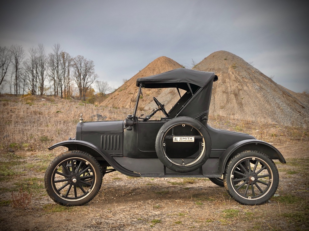

I have been driving my 23 runabout nearly every day for the past few years and an average of 100 miles a week except when the snow is deep on the road, which isn’t very often these days.
I have found it to be very reliable transportation and am often curious how others don’t have the same experience with their cars. I use a New Day timer and wipe out the track with very fine sand paper about every 2000 miles. At that time I also clean the plugs and check the original wood box coils (w/ new capacitors) on a hand crank coil tester. I make sure all the connections are clean and tight. Regular maintenance is how you get a reliable car. The more you drive your car the better you can tell when it’s not up to par … and what to do about it.
It was 30 degrees out when I started the car to go shopping this morning. I step on the starter with the ignition off and full choke for three revolutions and then back off on the choke a little and turn the ignition to battery and it almost always starts on compression (no starter motor needed). At the end of my drives I leave the lever forward to squeeze out the crankcase oil and hook up the battery to a trickle charger. Both of the latter make it easier to start the next morning.

Nice to see the Ideal Timer is living up to its name and its claim. Thanks for sharing your experiences using it.
