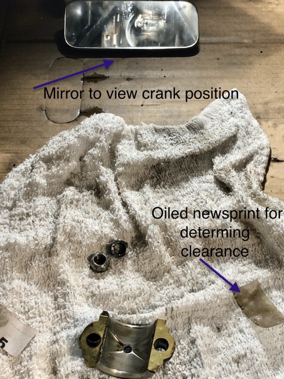

Yep, oiled newsprint for checking clearance when removing shims. Shade tree mechanics Plastigage
Use a fresh piece of print for each cap. With paper between crank and cap, if too tight to turn over, you know the clearance is ok when the paper is removed.
