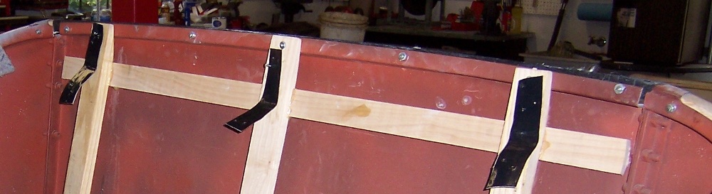

by DanTreace
Original wood tack strips on the '26-'27 were steam bent wood, 3- 4 pieces. These had a routed step in the outer edge, to allow the backrest upholstery to lay below the top cover, so the trim looked neat.
Have used kit wood and it does need a lot of work to fit right. Oak is strong but hard to shape, needing to cut on radius to make the curved pieces.
Pictures is a '24-'25 strip, original below and repro by J P Anderson on top, he makes these steam bent. Plastic is shown to the top left.
For my use the plastic trim is easy to shape with a hot air gun, and holds tacks very well, easy to drill holes to mount to the metal. In this install used cut-down kit wood on the sides, as the bends didn't fit well to my body, and then used plastic for the longer back piece. Prefer the plastic.
