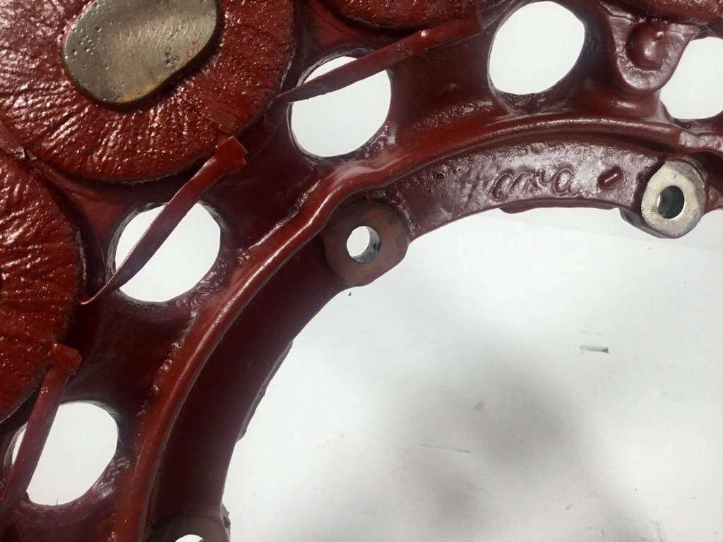

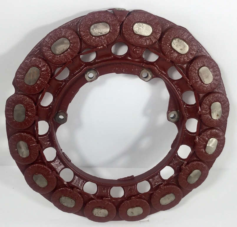

Thank you for your input. A little clarification is in order on my part. The following information is listed in the description on eBay, but I figure I had better list it here as well. When I received the coil from Wally, I had never seen the clear yellow resin so I was unsure of whether it was heat cured or how well it would hold up inside the harsh environment of the transmission, but I was familiar with the protective qualities of Glyptal, so I took the extra precaution of applying a coat of Glyptal and heat treating it for two hours in a 250 degree oven as the instructions call for (www.mtfca.com/discus/messages/118802/152476.html). Since Glyptal is what Ford originally used to seal the magneto coils I figured it could only help. At the time, in July, 2010, I ordered two rebuilt coils from Wally. This one and the one I put in my 1926 coupe, which, at the time I was overhauling and applying Glyptal to the oil pan, engine block and hogshead. I applied Glyptal to the one I used as well and after 11 years, the Glyptal is still holding up great! The results of my curing the Glyptal coated magneto coils was a rock hard coating of Glyptal in addition to the clear yellow resin seal that Wally used so it should be extra well protected from the heat and oil of the running engine for as long as you own your T. I looked up the price of a rebuilt coil at Lang’s which is $299.00, which does not include the $50.00 core charge or the $25.00 or more shipping costs for the 16.6 lb. coil that will be incurred to ship the core to them. A $75.00 savings in addition to not having to wait for the coil and additional benefit of having a new coil rebuilt by Wally. Everyone have a Merry Christmas. Jim Patrick

Red Glyptal was developed by GE during the Model T era to use as a protective insulator for the windings of electric motors being developed by Thomas Edison. GE is the company started by Thomas Edison and since Edison and Henry Ford were very close, of course Ford adopted Glyptal for use on his Model T production line and, as it turned out, was the best product for the purpose of insulating the windings of the generator, starter and magneto coils. Jim Patrick

Here’s what I used in the mid 70’s. Krylon no.7004 insulating varnish and probably a form of glyptol. This can has been around 50+ years. I forgot I still had it. Then read this post and I remembered I kept the last can I had. Krylon was founded in 1947 and Glyptol was developed in the teens by GE or so I read online.
It’s interesting that Borden owned it along the way and sold its interests to others in the 90’s.
Reading the back of the can it must be some potent stuff. When I coated the mag ring on my first tare down of my 24 coupe in the seventies I sprayed it the same red color as J Bartows pic of his. It held up pretty well considering I cleaned up the mag ring with kerosene and dried it off, let dry and sprayed it! Nobody was rewinding them that Iknew off at the time.
