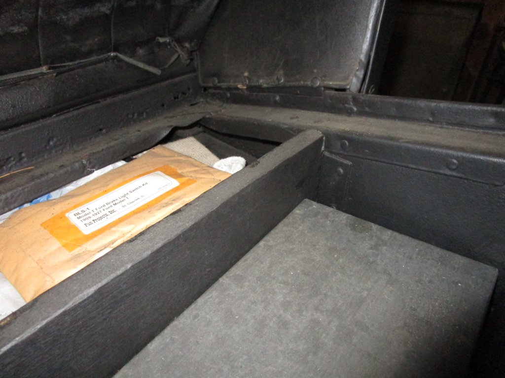

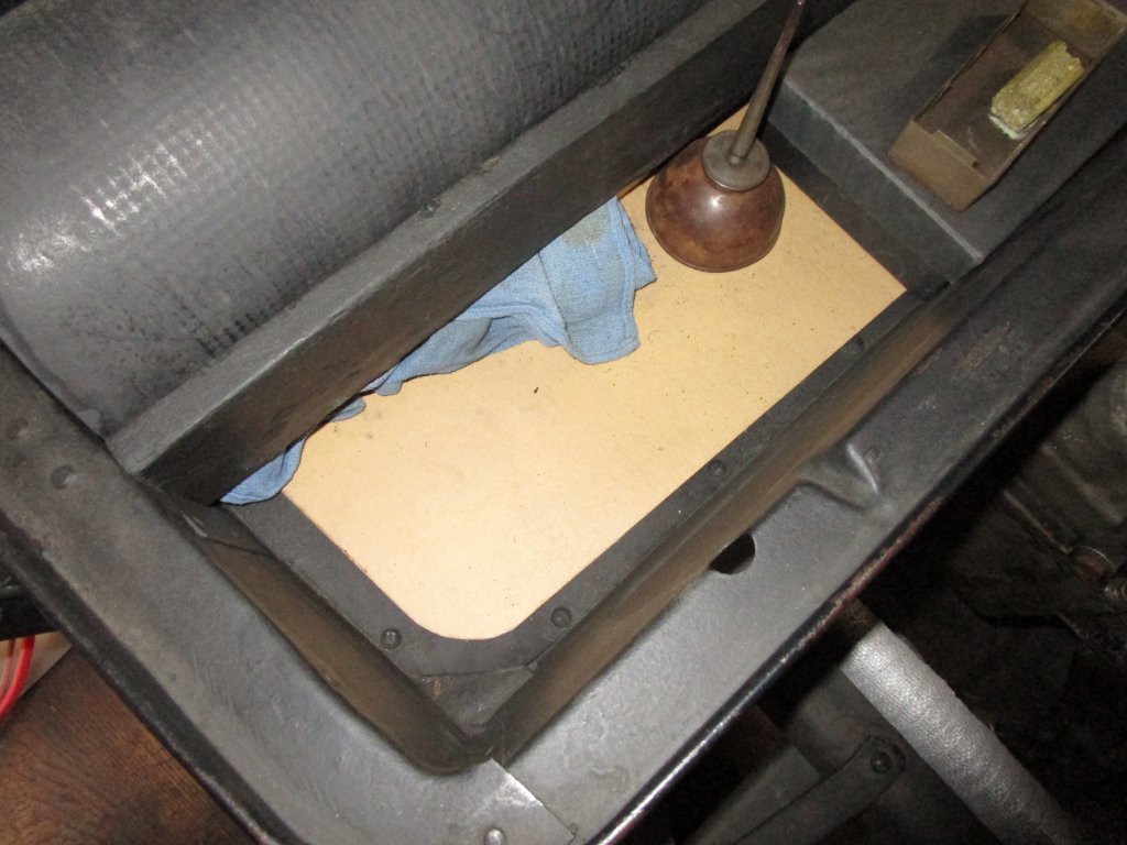

Here are a few pics showing the springs, the cross board, how the hip panel attaches, the cardboard "anti-rattle" panel in the bottom of the seat frame, etc. .... If you need any more pics, let me know. My car is a very late 27. All the wood in my car is original. Early to mid 26 did not use the little metal trim channel around the hip panels. I'm unsure as to the exact "date of change" They just tacked in place similar to the door panels. Front and rear seat areas are basically the same.

Re: Do 26/7 touring seats have a wood frame?
Posted: Thu Dec 23, 2021 11:18 am
by dobro1956
Posted: Thu Dec 23, 2021 11:19 am
by dobro1956
