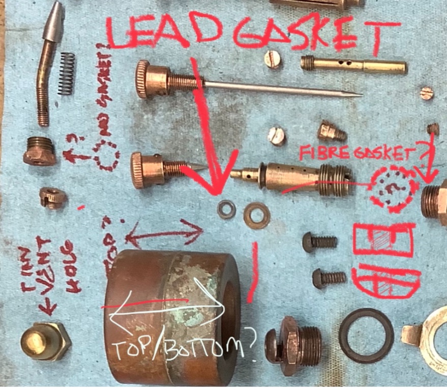

A couple enthusiasts I know are working on their OF carbs this winter. I’ve permission to post some PIcs with questions. So, if you’ve been into one of these desirable carbs, feel free to jump in with hints and advice.
Re: Rebuilding your OF Stromberg
Posted: Sun Jan 16, 2022 2:51 pm
by Dropacent
Posted: Sun Jan 16, 2022 5:04 pm
by George House
That doesn’t appear to me to be a “ very simple carb” or “a piece of cake” Tim but thanks for stirring discussion on this topic.
Posted: Sun Jan 16, 2022 5:52 pm
by Dropacent
You seldom see them 100% apart, which I thought would be quite helpful. You are welcome to stroll on by George, and I really don’t understand the need for the commentary.

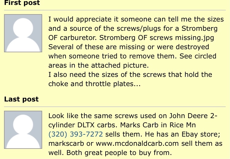

Info added from discussion in the classifieds. Size and modern source of sealing screws.

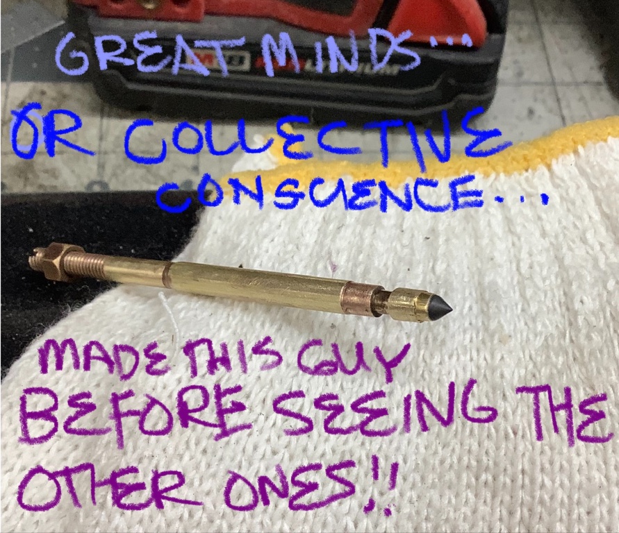

Posted: Mon Jan 31, 2022 9:07 am
by Randall strickland
Tim here’s one I started doing a while back is this the needle you are asking about
Posted: Mon Jan 31, 2022 9:09 am
Can’t get it to post
Posted: Mon Jan 31, 2022 9:11 am
Posted: Mon Jan 31, 2022 1:04 pm
by Dropacent
Thanks Randall, I believe that will help him. Appreciate the effort. He has a lot of other questions written on his pics posted above, if anyone wants to help, he would appreciate it. Thanks!

Posted: Thu Feb 03, 2022 1:56 am
by Duey_C
Tim, have you told the fella with the great pics that the float doesn't care if it's upside down or otherwise? :)
In my updraft M-series world, if the float doesn't have any deviations on the flat ends, It's all good either way. VERY similar.
Sorry, I'm enjoying these photos.
Posted: Thu Feb 03, 2022 6:09 am
by Dropacent
I haven’t told him anything, as I’ve never been into one of those. So, really appreciate the feedback. I’ve been hoping for more, but I’m sure he appreciates your comments, too.
Posted: Sat Feb 05, 2022 1:16 am
by Duey_C
Here’s what I was referring to and hopefully adding small info. Floats.
The gentlemen questioned which end is UP on the float. USUALLY doesn’t matter.
I ran into one Stromberg #1 float that had a deviation on a bottom-end surface.
Float 1. Part of the surface is “caved in” so NOT a good end to be on top for the needle counterweight levers.
Float 2 Top. Nice flat surface with the smallest of deviations so when the float turns like they do, it’ll work the same. Look for marks or solder on the float end surfaces.
The pic of the “bottom?” of the float shown above APPEARS to be quite flat so also a good end to be on top.
#1 float dimensions are 2“ wide and 1-19/32“ tall. There may be slight stamping/manufacturing differences.
I’ll stay my fingertips on other thoughts. This I will say, take the economizer out of the equation and they are very simple carbs and that intrigues me. Giovanni Venturi and Henri Pitot helped them work.

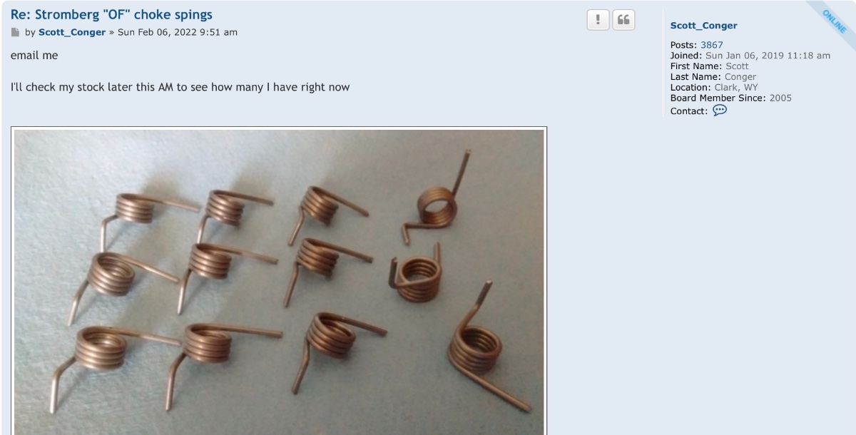

Thanks Duane, hope he’s following. I expect so. I’ve had another inquiry about the small choke spring. Anybody have them available, shout out! He needs two, but I’d expect there are others interested.
Posted: Sun Feb 06, 2022 11:45 am
by Dropacent
Here ya go, Scott has the choke springs. Things of beauty. He who hesitates is lost!

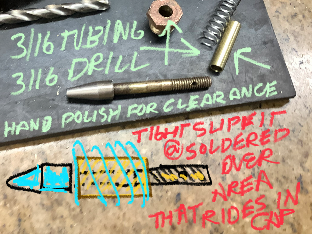

Posted: Mon Feb 14, 2022 12:48 pm
by Dropacent
There was a discussion awhile back about mounting holes that have been drilled or wallored out. Helicoils work dandy, an easy fix. Sure a lot easier than other methods of suggested repair.
Posted: Tue Feb 15, 2022 9:58 pm
by Dropacent
Some more details sent to me. Great inside work this time of year.
