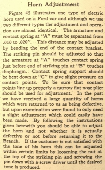

Think is was a Ford Ames version I took apart and didn't see a gasket. The hint of using writing paper (not copier paper) would be ok, manilla file folder stock would be too thick IMO.
When you get to adjusting, here is the Ford Service Bulletin info:
IMG_5065 (484x780) (341x550).jpg (153.47 KiB) Viewed 1761 times
