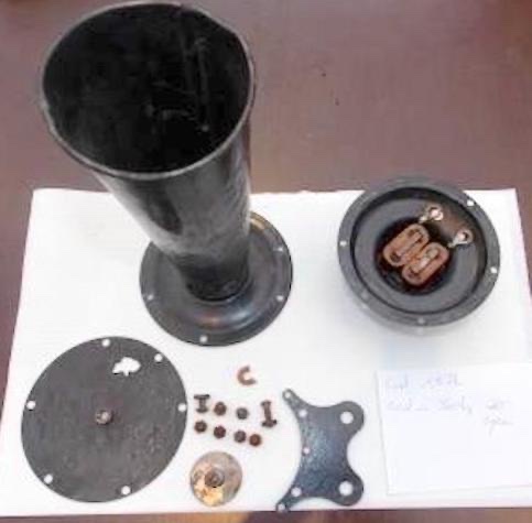

Tried to adjust my magneto horn, barely put any pressure on the stuck nut and the brass bolt snapped right in half. The lower half of the bolt is still in there. How difficult is this gonna be to fix? Is there an easy way to replace the bolt or should I get to soldering?

Haven't repaired a magneto horn before, but others have.
Took this photo off the web, and it shows the mag horn with its pieces apart.
That brass bolt perhaps is part of the piece that drives the diaphragm. Maybe the photo helps.
