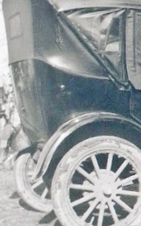

Agree with you there too. IMO the top prop rods and saddle and straps were just placed in the car, same as the tool kit, perhaps in a box? Anyway, these parts are needed for the top to be folded down. The mention of these in in the Service Bulletin. Aug 1922, with illustration on how to raise and lower the new 'one man' top. Without these the top irons would collapse over the back of the body!
And many photos show the plugs in place on original cars, when the top prop rods aren't in use. If you have ever squeezed yourself into the trailer/garage when the T has the T "up" and those rods are sticking out......well.....I have hit my elbow on 'em a few times, and they can snatch your shirt too!
The plugs were placed prior to shipping, as the top prop rods could cause trouble in shipping a car. Photos seen show the top assembly fully released and hung down and secured with strapping......that way the top assembly took way less room in packing in the car.
Note this Improved runabout in the box car, top is hanging down and certainly not be supported by the prop rod, saddle and its little leather straps for shipping. :)
Plugs in place.

So... it looks like they shipped the cars with the saddles inside and the top collapsed... maybe tied down, or up, or with some kind of carboard spacer or whatever. That makes sense. Anyway, I need to get a pair of them and the related straps.
