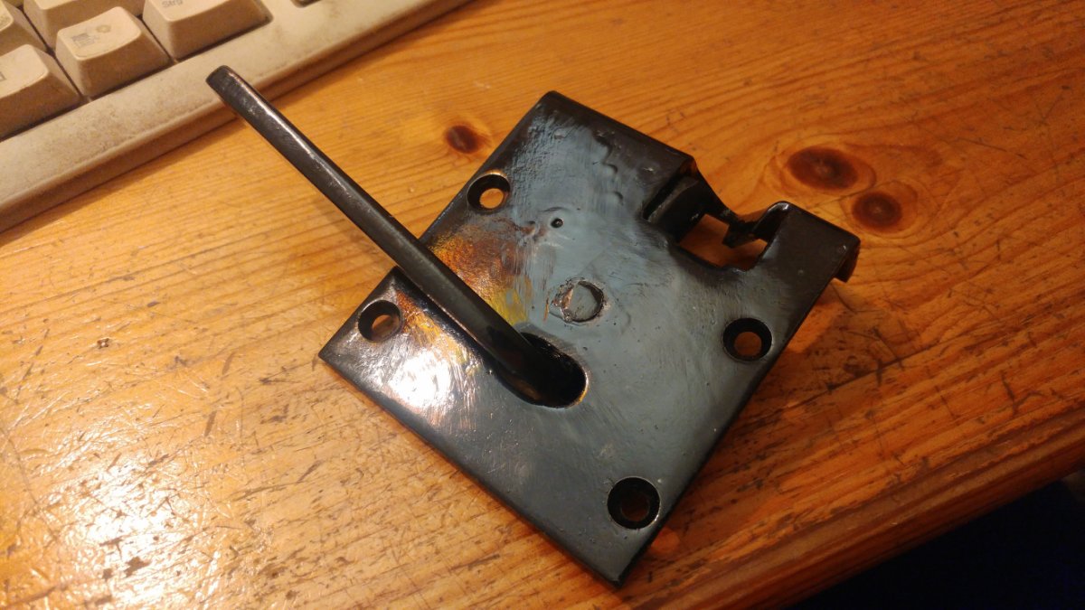

Hello.
I am currently restoring the front door of my '16 Touring. I had to partially remove nails from inner coverage to reach the innermost screws of door latch. The door didn't reliably lock so I wanted to repair the lock mechanism. This worked fine, the lock is now as good as new, the spiral spring was over-bent. Reason, the latch has an edge closer to the spring, pushing the spring up ways too much. I finally cut away this edge, now the spring can work as it should. I finally bent the brass spring back to its former shape, replaced the grinded off rivet heads by a M5 bolt going through the entire lock, repainted and greased everything with chain grease spray (as used on motorcycle chains, it is very sticky)...
Modified door latch
Modified door latch
Finished door lock
Finished door lock
Finished door lock - Rear side
I think the lock is well done now.
