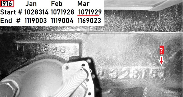

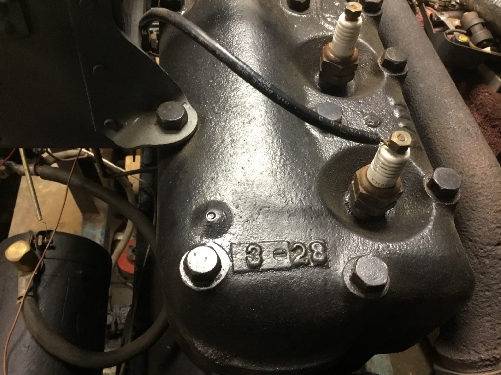

Matching dates common?
How common is it for a15 block and head to have same casting date?

A random occurrence. Probably did not happen a lot, but not all that rare either.
I have known of hobbyists that made some effort to match them up during restoration.

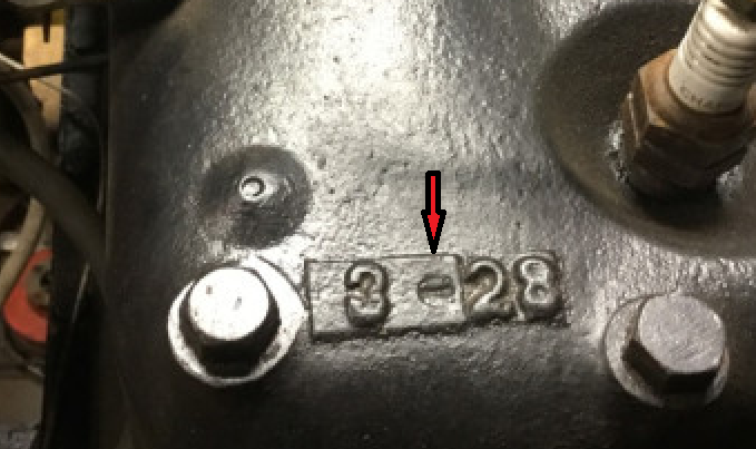

Re: Matching dates common?
In real life, the last part of the date looks like where they secured the date tag in the molding process. And yes the date in the head looks to have been secured by a slotted screw. And then that brings up the question why is the casting of the screw not reversed? With the slot not sticking up instead of looking like a screw slot
Ford didn't make a new mold every day just to change the date, they changed per day by screwing the numbered plates on.

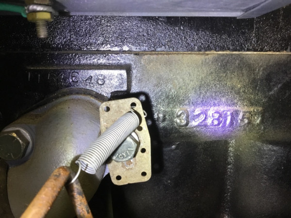

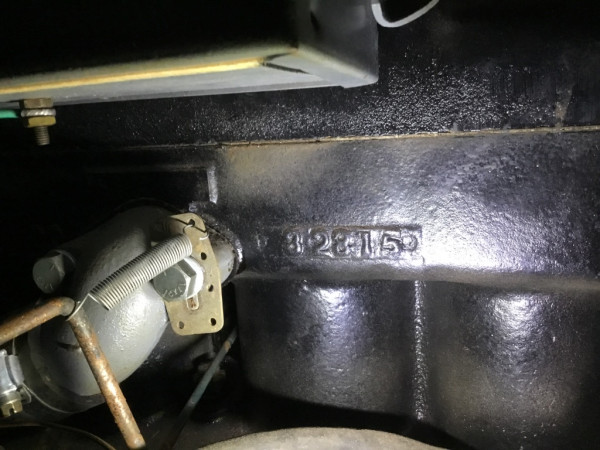

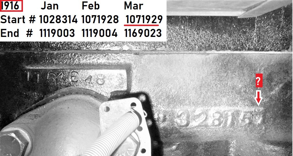

- Posts: 4416
Interesting. I had not looked closely at the serial number pad before. But there is another anomaly. As production neared the one million mark, Ford enlarged the serial number pad for the blocks on the patterns and/or molds. The earliest I have noticed the larger pads is around the Fall of1915. The smaller number pads continued to show up as Ford continued to use the already made patterns and molds with the smaller pads already in place. I have seen smaller number pads well into January of 1916.
This block has the larger number pad common for 1916. I could be wrong? But I do not think a March of 1915 block should have that size number pad. Do not ask me how or who, but I do know for a fact that it is not difficult to convert a 6 into a 5.
As for the casting dates themselves? These are typical. Molds and/or patterns had places for date numbers to be attached before the iron was poured. Several variations of attachment were used, among the most common was slotted screws. The slotted screw can show up as either a positive or a negative depending upon where in the process it was changed. The level of the numbers often varies.

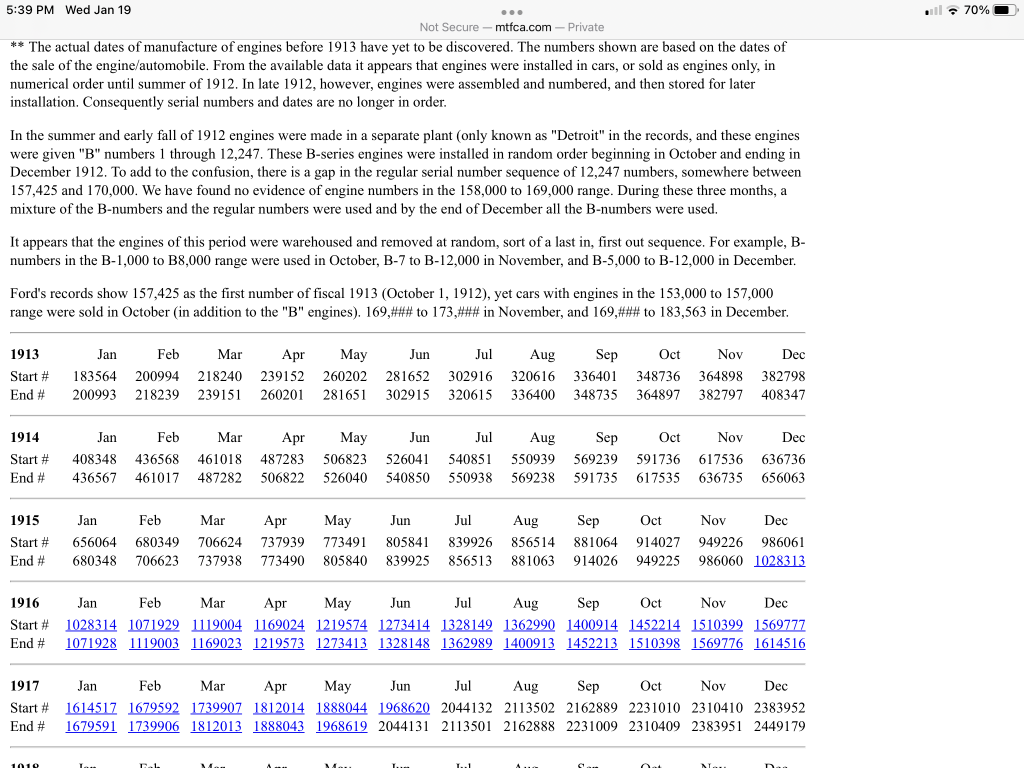

My block is dated 4/14/15 and the car assembled on 4/24/15. So engine blocks must not have aged a whole lot before machining. It probably would’ve taken a warehouse a square mile in size if they aged very long before machining.

You guys are right as rain. The serial number is a March 1916 not 15 I guess at some point in the past someone tried pull one over. I sure stand corrected. That’s the reason the 5 look’s funky.

I would not worry about the 15 casting date and the 16 engine number. The longer number boss blocks were cast at the same time as the older shorter number boss blocks were in 1915. As the molds wore out they were replaced with longer boss molds. The shorter boss blocks would have been used up first while the numbers were under 1M by stacking the long boss blocks in bottom of the stacks ready to go to machining. I don’t think your 5 is a changed 6 in this case because the engine number would have also been changed to a 15 number. One case I can think of is a Ford dealer had a 1915 unnumbered new replacement short block in stock for a while and a customer with a 1916 T needed a replacement for a damaged block and the 1916 engine number of that damaged block was stamped on the unnumbered short block in that car.

As I understand it the number on the block (VIN) was stamped after the engine was completed & inventoried, depending on which Branch/Plant assembled the car, it could be weeks away from that number, as the completed engine would be assembled in Detroit & used there or shipped to a Branch. The Encyclopedia listing of dates relative to the (VIN) number is for that purpose only so because an Engine is dated x-xx-xx may not be the date the car was completed. George Hand

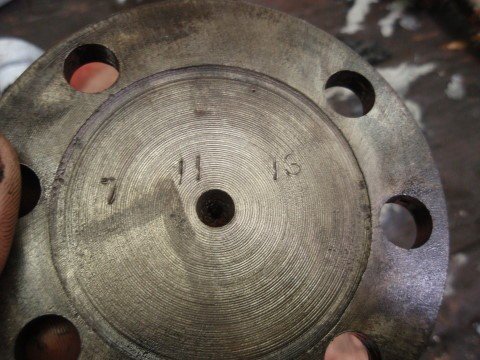

Not matching of course but,
another date on a completed "new engine assembly" for reference if you have the engine apart.
The transmission stub shaft was dated when the transmissions were assembled.
The transmissions seem to be assembled about a week or two prior to engine assembly and numbering.
My July 1913 block was cast in June, transmission dated " 7 11 13 ", and engine numbered July 17, 1913,
in Bruce's Book.
in Bruce's Book.

My 1913 has a 2/10/13 casting date on the motor. Engine #216761 which dates to 2/27/13 and the date on the end of the mainshaft of the transmission is also 2/27/13.

Interesting, engine assembly that week was right on top
of the transmission assembly department. My block casting
was also about three weeks ahead of engine assembly in July.
Would seem to indicate "engine assembly" dates in the book
are accurate for the time period.

About the remark about the screwhead not being cast in the "negative" : the small plate is screwed on the wood 'plug' or 'core' (officially called the 'pattern' ) and not on the sand mold, so will end up in the finished casting just the way it looks on the plug, chewed up slot and all.
