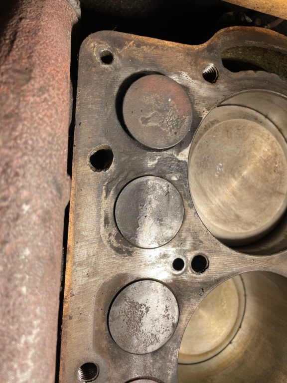

Is it pretty obvious when your T has had seat inserts installed? Below are a few pictures of my valve seats. Seems to be an excessive amount of concentric circles around most of the valves. Are these inserts? If so, are all inserts hardened?

Interesting variety of sizes used. If memory serves, there are or were 3 harnesses. 1) cast iron. (soft.) 2) hardened. Normal for unleaded fuels & 3) real hard (for propane)

Yes Ryan, those are aftermarket inserts of some kind. The valves in both my 1924 and 1925 engines have seats machined directly into the cast iron of the block.

For a T engine, any “hard” seat is fine. Yes, there are different alloys and hardness available... but the low operating temperatures of the T engine do not require anything different/better than the original iron. The major contributor to valve seat recession, is the low operating temperature of the original carbon steel exhaust valves. Swap out the valves for a nice set of stainless steel valves, and valve seat wear becomes a thing of the past... with or without hard seats
