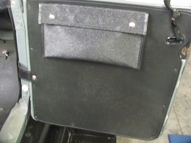

Right now I finished the restoration of my front door, so I want to post a final picture.
- Finished door
I think I will not paint the tacks black, this decent brass looks nice.
What I did was gluing the original door pocket to a sheet of model-airplane plywood (thickness 1.5 mm), using a permanently elastic PU glue. The plywood was protected first by several layers of parquet paint. The edges are covered by a stripe of new "artificial leather" to hide the extremely bad edges of the door pocket. Because sewing does not work through plywood (at least I don't want to ruin a sewing machine), I glued the ribbon to the edges.
Now the door looks lots better but still matches the overall look of my Lizzy.
