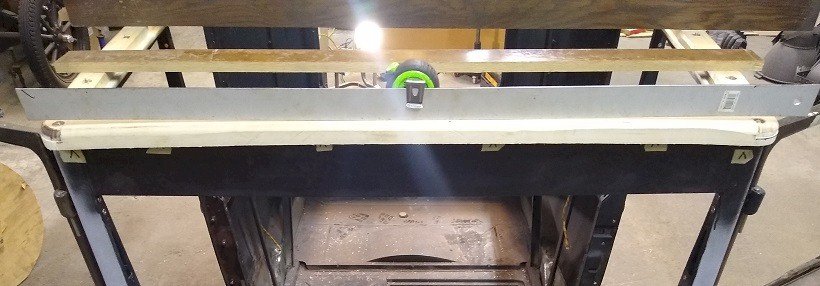

by ITDave
Here's what I'm faced with. I don't think this is normal. Thanks for all of your comments.

Re: 1927 Roof Wood Replacement
Posted: Fri Feb 11, 2022 8:53 pm
by ITDave
James, thank you for pointing me in the right direction. I did some measuring and it turns out that my entire body has bent back and down to the rear of the car. I've got some work ahead of me to get it square again. Interestingly, someone put a new top on the car many years ago. Instead of squaring things up, they just hand made side rails to compensate for the problem. It must have been done 50 or 60 years ago. It was a really bad job but the side rails looked okay until I put the new ones up there.
