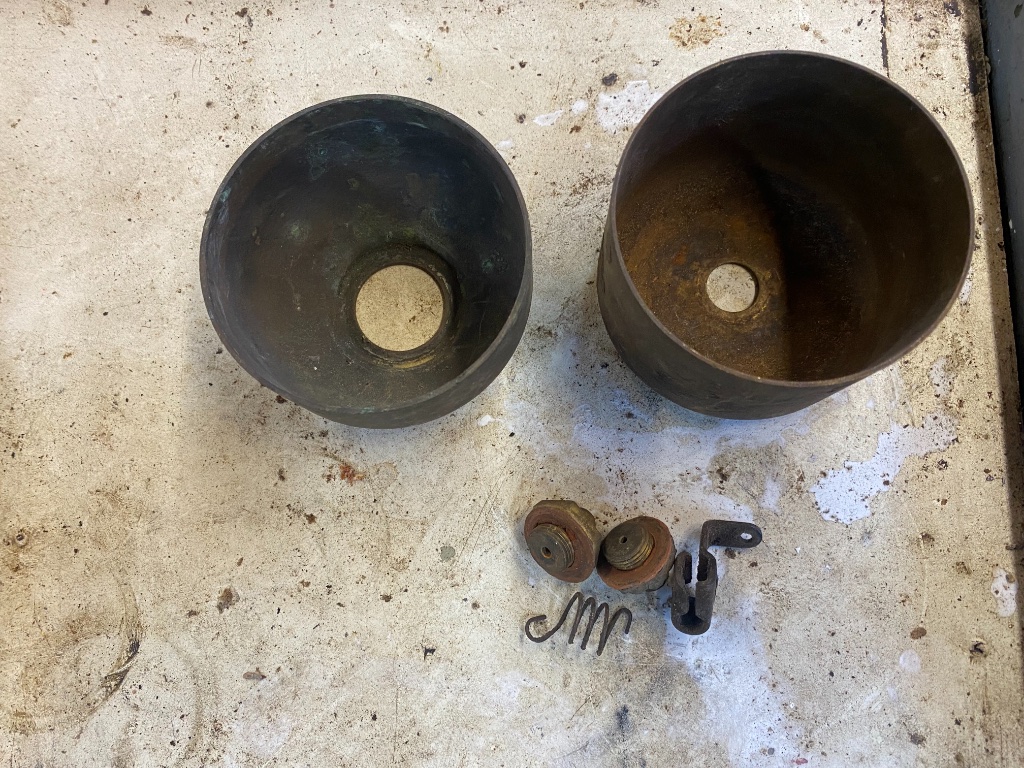

I have these two brass bowls and they are 3 inch diameter. The NH bowls are 2 7/8 inch diameter. The one has a 1 inch center hole and the other has a 1/2 inch center hole. I am interested I learning what they fit.

My Holley 2 screw is just a hair under 3" and has about an inch hole.

The taller bowl looks like the ones on Carter Carbs used on late 20s Chevys. My 28 uses a Carter RAKX-0

I could really use the short one for the Holly S for my ‘13 touring. Is it available?
