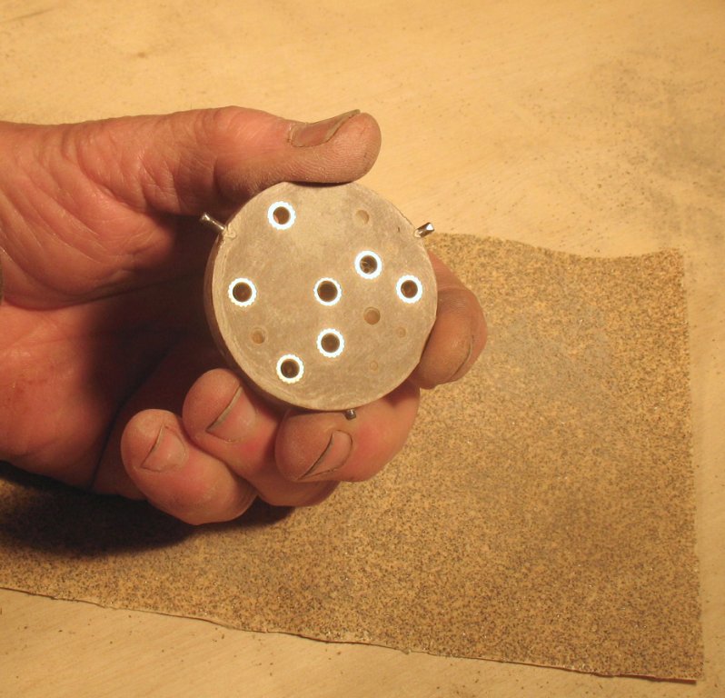

After a hundred years, sometimes the switch backing plate has become warped, causing intermittent contact. You can flatten it on coarse sandpaper. After flattening, you may need to deepen some of the dimples a little.
Some switches have backing plates held in by pins, like this one. Others have bent-over tabs. If you have one of those you'll have to unbend the tabs to get the backing plate out. While you have the switch apart, turn the tabs red and let them cool so they won't break off when you re-bend them.

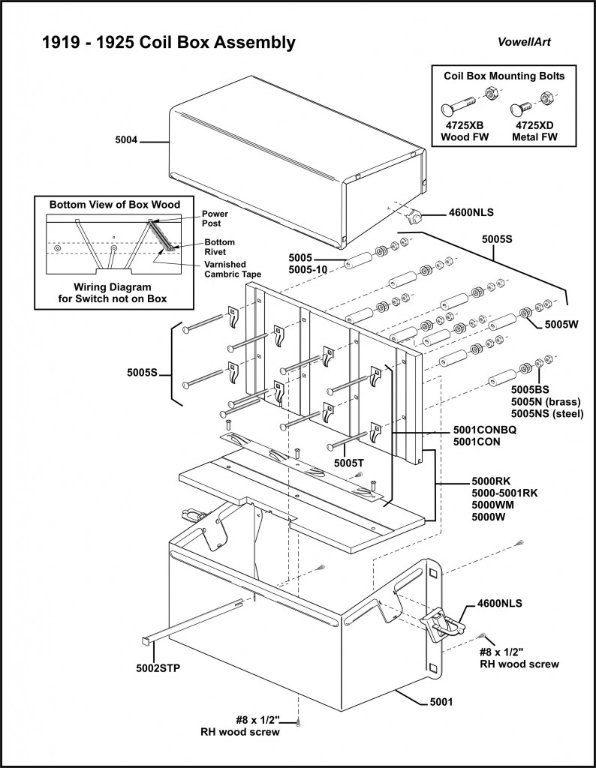

How is your coil box wired. Normally the MAG post on the box on a starter car is left out or not connected to the the center strip inside the box. So hot wiring to that post would do nothing. You can remove all the coils and test continuity from the MAG post to center strip inside the box and the same for the BAT post. The post with the continuity connects to the switch center, "coil", position on t he switch via the terminal block

Check your wiring from the diagram I posted above.

We are confident that the four coil boxes are in OK shape because the engine runs smoothly on battery. We again observed that the magneto will brightly light an 1156 bulb. We again tried a bridge wire from the magneto post straight to the housing input terminal, after starting on battery and then switching to off and also to magneto. This to avoid any contact with the 6V supply. All we could get is a few pops and spits, she would not run.
