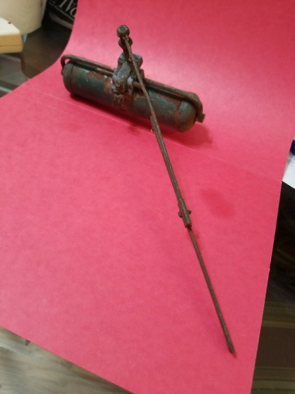

But then I was looking through the classifieds and found this Apco (alas, too late!):
Was it one of these?
So my question is, who made this accessory that was available for Australian cars?

John , having owned several originals, they are made by Trico, but not common at all. One of the very hardest to find late model T accessories. They are close to the regular Trico wiper, but just about nothing is interchangeable, other than the wiper arm. The actual ford supplied units have a round etched disc with the Ford logo on it. Two different models, one for open cars and one for closed cars. They were made from bad potmetal, so very hard to find one that isn’t warped and cracked. The arms for them are made as a perfect reproduction by A & L . They supply mostly model A very high quality reproduction parts, wholesale only. Hope this is some help. Good luck on the search, that is half the fun.

I have that export catalog and I believe those are folberth.
