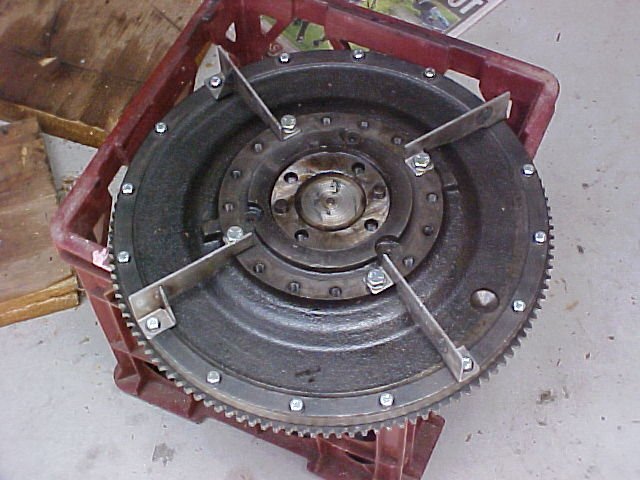

Texas T slingers "had" a reputation for coming apart. Dont know about now, but wouldnt take a chance. I make 4 slingers from T6 90 degree x 3/4" x 1/8" extrusion, full magnet length on spools, Running them in 3 of my own & a dozen or so customers. No issues. Moves a lot of oil.

Hank, #1 do you make your own slingers, and #2 why do you cut them down on the width?

Do not make my own anymore.., cut down the width to break down over loading unnecessary drag, add 8 total for better balance.

Using 8 slingers instead of 4 might reduce horspower loss at higher speeds by causing troughing effect, which would introduce slippage. With 8 slingers, liquid oil would only have 1/2 the time to flow in behind one slinger before the next one came by.

Narrowing the vane will reduce torque and drag. I use an outside oil line as well.
