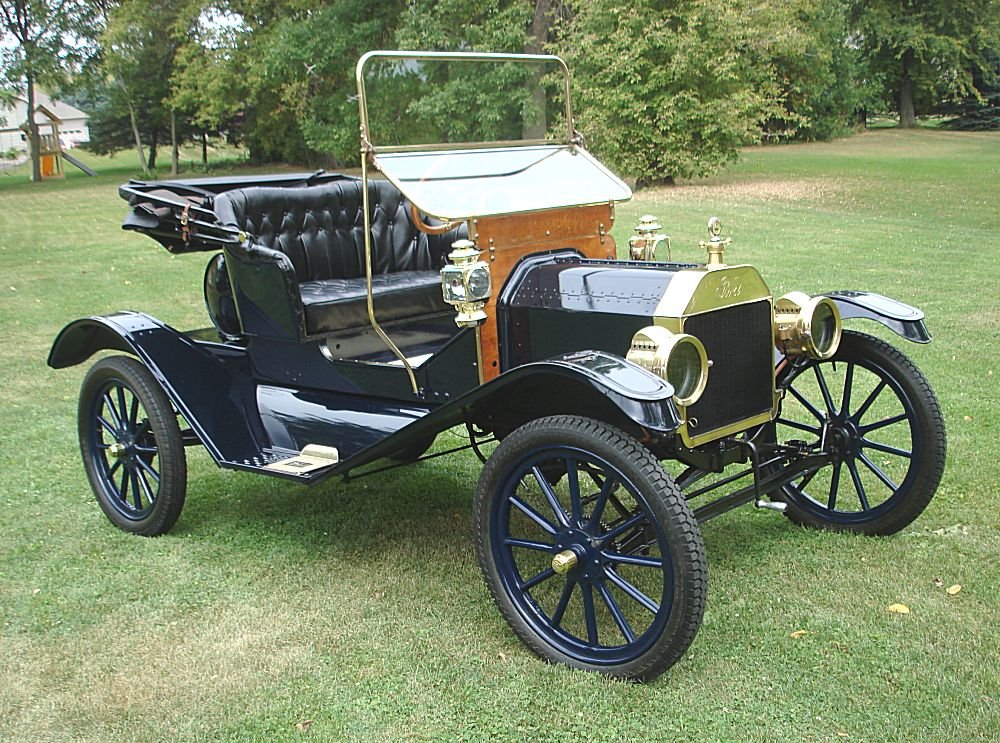

Below are a few photos showing my 1911 Open Runabout in various light conditions. My car was painted using a color code from 1985 Mercedes Benz which was called "Dark Blue" # DB-904. The color is a very deep blue in bright light and looks almost black in low light.

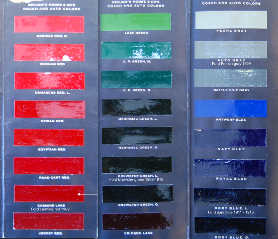

A few years ago I went to three paint stores in Carson, Torrance and Gardena looking for lacquer thinner. They all told me it couldn't be sold in California anymore. Then I went into the Home Depot at Lomita Boulevard and Crenshaw and found — guess what — shelves filled with quart and gallon cans of lacquer thinner! Some stories of "banned in California" are true. Others are pure baloney.
I suspect this was shot with a camera. I would like to see if a scanned version would be better lit.

I would be interested to see what color that Benjamin Moore 1911-1913 body blue is. Any idea what year are those color chips were produced?
The picture file is labeled 1910.

The color chip sample board is certainly not from the year 1910 - I presume it is meant to represent colors used in 1910.
I don't want to seem "impossible", but seeking the actual, equivalent and authentic paint for a 112 year old automobile is like hunting for a unicorn. For one thing, the materials and methods used were entirely different. Even the pigment stuffs are now very different. Note the formula on the printed page above which calls for "phthalto [sic] blue". Phthalo cyanine pigment was not available commercially until the late 1930s.
Some have been able to resort to original surviving samples from "protected" areas (underside of hoods, inside seat frames, etc.) and while these provide the best authentic point of reference for matching modern materials, although protected from sun-fade, the fact that paint films made with natural drying oils and resins darken considerably as they age, and even more so when held away from natural ambient light seems to be generally overlooked, as is the possibility of color changes due to environmental factors (exhaust fumes, gasoline vapors, industrial atmospheres, etc.)

That 1910 paint chip card that Steve posted is from 1910. It's in the collection of the Hagley Library.
