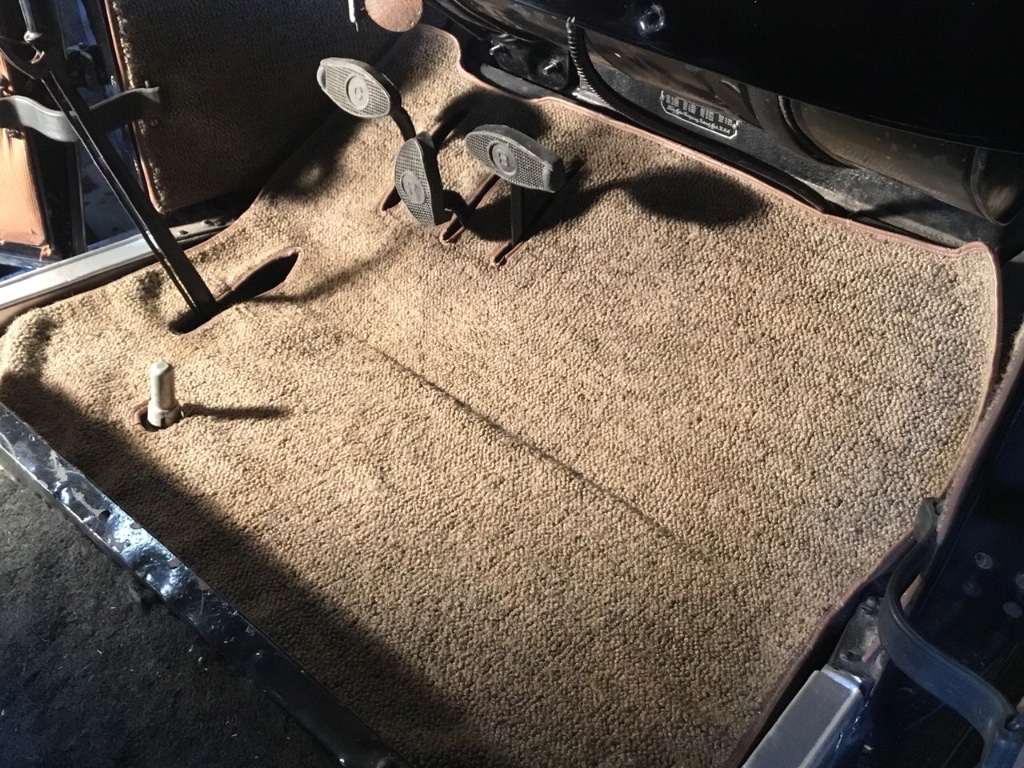

I have a fitted carpet with openings (emergency brake lever, clutch pedal, reverse pedal, brake pedal and starter button hole) in all the right places in my 1926 that was in the upholstery kit supplied by Carter’s Cut and cover in 1972. It fits great but, when I got it, it would not stay put and bunched up, so I purchased a snap kit from McMaster Carr and put a snap on all four corners and screwed the male portion of the snap to the wooden floor. It has been perfect for 50 years and I love it. Jim Patrick

If you want to be correct, open cars had rubber mats and closed cars had carpet. If, in stock, Lang’s catalog shows that they have fitted carpets with hemmed holes in a variety of colors (black brown and grey). They also have the snap kits for securing the carpet to the wooden floor. Snyder’s only has the rubber mats for open cars that do not fit closed cars unless they are trimmed to size and it is very difficult to trim that thick rubber so it looks good. Jim Patrick
