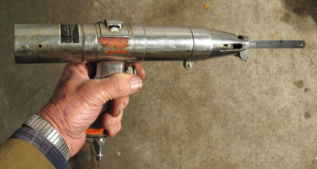

I probably should have removed the radiator, but I didn't.
I agree that a hacksaw is handy for removing the old bushing.

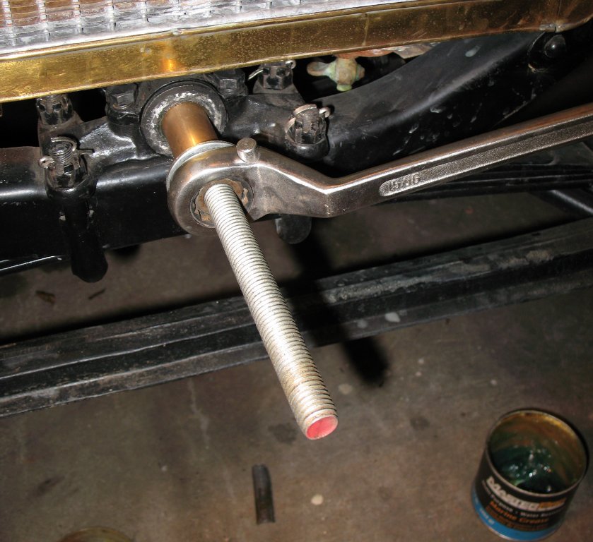

I like bronze bushings
There's no need to bang away with a BFH if you press the bushing in with all thread. Note the can of grease to help the bushing slide.
I didn't have to turn down the OD, but I did need to hit the ID with a ¾" reamer to get the crank in.
