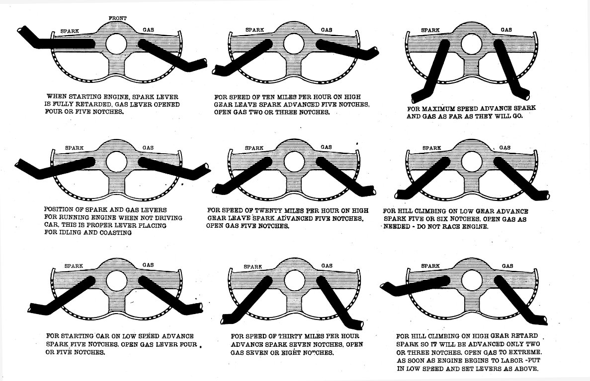

The levers just under the steering wheel are very important, too, in driving the car. The right one is the throttle and the left one controls the timing. While the attached diagram shows the general positions of the levers for various situations, each Model T is different and the lever positions may differ somewhat from T to T. Jim Patrick

...each Model T is different and the lever positions may differ somewhat from T to T.
That's one reason not to be a slave to Murray Fahnestock's diagram. Another is that when you're running on MAG, as most do, the range of spark lever movement is not a gradual continuum from fully retarded to fully advanced, as it is on BAT. On MAG the lever movement is across four sectors. With the lever all the way up, timing is fully retarded; all the way down, fully advanced. That leaves just two sectors in between. When running on MAG the timing lever has only four effective positions.
When starting on BAT, the spark lever must be all the way up (fully retarded). If your battery is dead, or you have no battery, or you just feel like doing it, you can start on MAG. The spark lever should be down a few notches to put it in the second sector. I'm not electrically educated enough to explain why.
Why start on BAT and run on MAG? When starting on MAG you have to turn the engine quickly enough to generate enough current to fire the coils. When starting on BAT the battery supplies the current and the engine only has to turn, not necessarily fast. Once the engine is started, the magneto is producing more voltage than the battery, so the engine runs better on MAG.
This is how fast the engine has to "spin" when you start on BAT: https://www.youtube.com/watch?v=3pv6HWWOGYA
