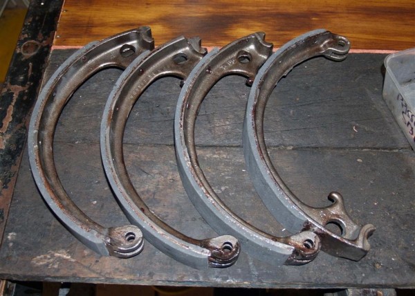

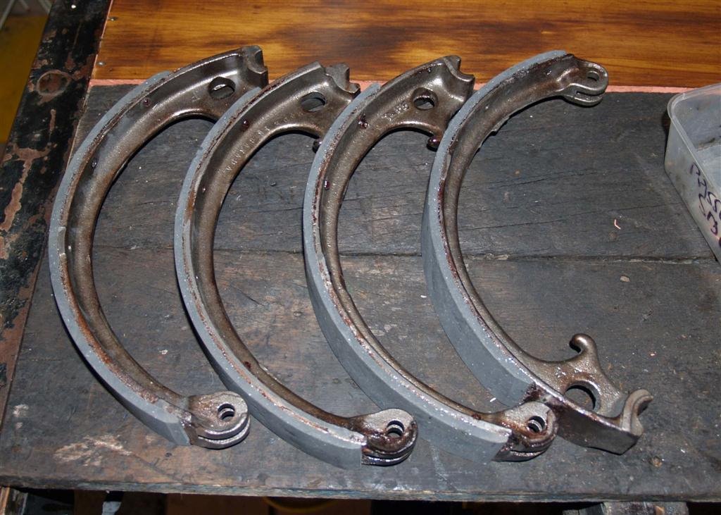

Why not get a brake shop to bond new pads on?
No rivets to come loose or damage the drums.
