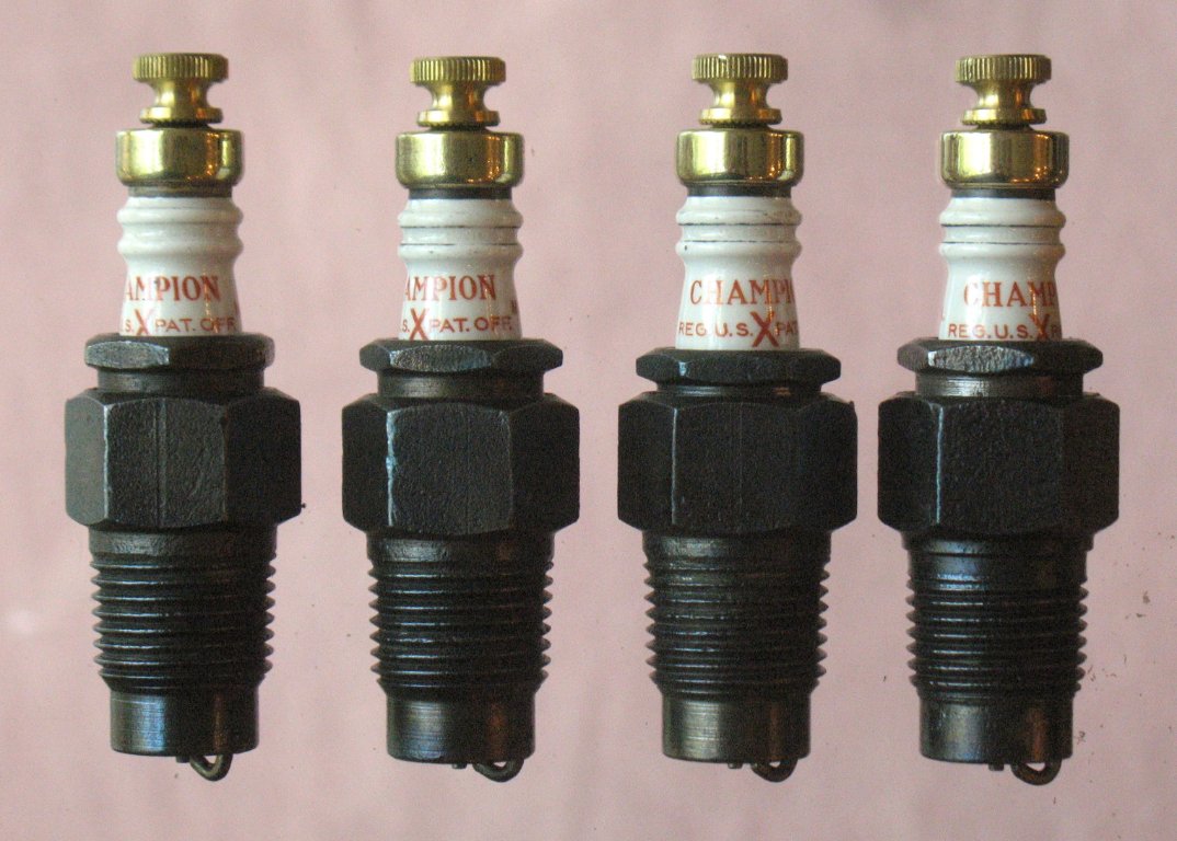

I used gun bluing on these. I think it looks pretty decent.

Those look great Steve!
