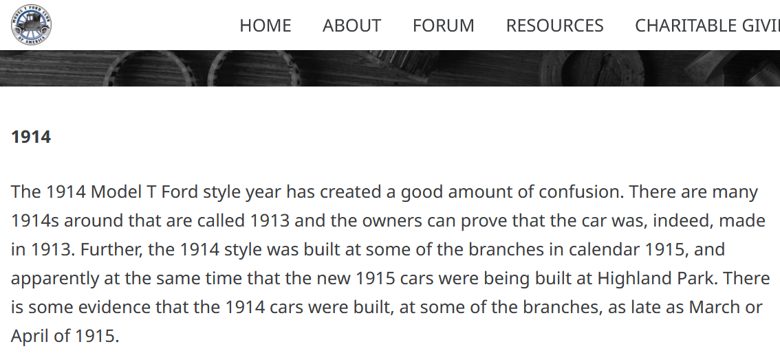

There are always discussions on "consumption" of inventory, so anything is possible. I found this interesting, so the questions is do you have a 1913 or 1914? You can't always rely on the Title and/or engine #
